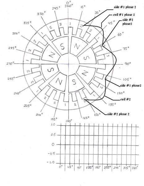

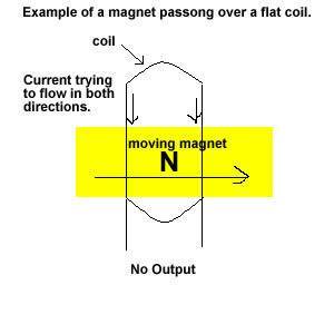

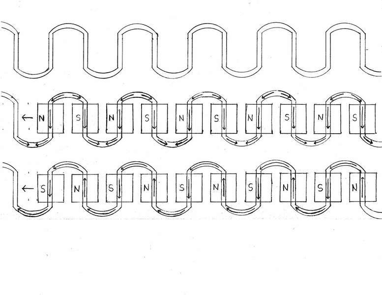

Hi everyone, I've been studying magnetic fields and alternating current generators and i have a question i need help answering. I have posted a few other questions in which i posted my generator design with magnet placement and plotted the sine waves on a chart but i have a question about the direction and length of current flow created by the magnets. i have drawn a diagram of the coils and magnets to try to understand what's happening in the conductor at a given point in time. I have read that an approaching north pole magnet creates a counter-clockwise current and an approaching south pole magnet creates a clockwise current. I also understand the alternating current moves from point A to point B and back in a determined amount of time. In the diagram below, which direction of flow is correct? I have read info on the internet that i don't know is correct so ill post it here also to show why I am a little confused. here is what i read and the diagram of the north pole magnet with single coil applies to this quote :
" I intuitively felt there was a problem. And this is where I had to do some learning about magnets and coils. And what I found out was that when the magnet passes over the coil, as it first approaches the coil the current in the coil begins to flow in one particular direction. As the magnet begins to pass over the coil, half of the coil's current is trying to move in one direction and in the other half of the coil, current is trying to move in the other direction. Nothings going no ware. Now as the magnet exist the coil, current begins to move in the opposite direction of when the magnet approached the coil.This means you only have current flow, and only a little at that, when the magnet is entering or exiting the coil. As it passes directly over the coil, when max output would be expected, close to zero output would be realized. "

Your bottom diagram in the first picture seems OK, but the middle one shows the current going downwards regardless of magnet polarity. This can't be true.
The second picture shows both sides of the loop passing over a magnetic pole and this would result in no output, as you show.
Just use the bottom drawing in the first picture and see that the overall polarity will be reversed as the relative position of the coils and magnets reverses.

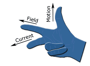

You can check these with Fleming's Right Hand Rule.

Don't forget that the field is not between magnets that are next to each other. It is between magnets that are on opposite sides of the path of the coil. Your diagram shows the bottom magnets of a matching upper set.
Like this:
[PLAIN]http://dl.dropbox.com/u/4222062/generator.PNG
Thats a great illustration Vk6kro, my illustration skills just arent that good. I have to visualize the interactions to understand them. I understand what you illustrated in a 3-dimensional kinda way, i can only draw in a 2 dimension way. Thank you for taking the time to illustrate this the way you did to make sure i understood what was happening, I really do appreciate it.

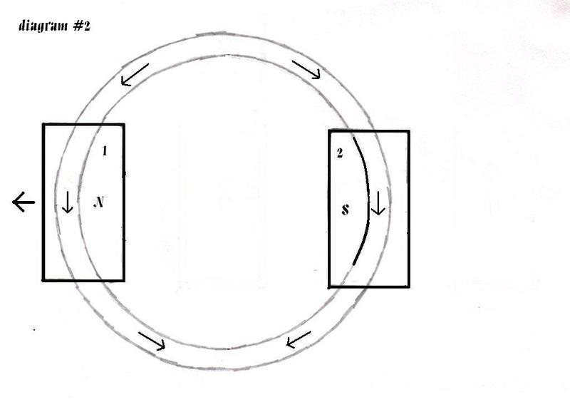

Hello everyone, i am back to this question because i can't grasp how to correctly place the alternating poles of the magnets in an a.c generator. In a three phase alternator there's a north pole placed over one side of the phase 2 and 3 coils while phase one is at 0 volts, then there's a south pole over the other side of the phase 2 and 3 coils while phase 1 is at o volts. Heres where I am confused, Lens Law states that an approaching north pole magnet will induce an (anti) counter-clockwise current flow and an approaching south pole magnet will induce a clockwise current flow, I am posting a couple diagrams to show why I am confused. In diagram #1 : I have placed a north pole magnet over each side of the circular loop of wire and based on Lens Law i get a counter-clock wise current flow through the complete loop but i have read everywhere on the internet and here that you have to have a north pole on one side of the loop and a south pole on the other side of the loop like i have in diagram #2, based on Lenz Laws there would be no current flow with a north pole on one side and a south pole on the other side, the currents would cancel each other out wouldn't they? I believe diagram #1 is the correct way to make current flow, have a north pole over each side of the coil or loop of wire causing a counter-clock wise current flow, then have the 2 south pole magnets rotated over the coil or loop of the wire causing a clockwise current flow creating the alternating current flow, am i right? can somebody help me understand this ?

The second diagram would illustrate the situation, but the current over the North pole is the wrong way around.
You would not have a loop like that either, as it would be a short circuit. You would take power out by breaking the loop at the top or bottom.
Try just following the right hand rule shown above, and the 3D drawing.
Thanks for the answer vk6kro, the closed loop is just an example to show that the magnets are positioned over each side of a multi-loop coil wound through a stator like in an automobile alternator. Could you elaborate why the current in the second diagram is flowing the wrong way? Lenz Law states that an approaching north pole magnet induces a counter-clockwise current, which is why i drew the arrow in that direction, could you please explain ?
If you approach a shorted coil of wire with a north pole, the coil of wire will generate a current that opposes the incoming pole by creating a new magnet with a north pole facing the incoming one.
But that is not happening here. The wire is passing across the north pole, not approaching it, and the whole coil is not approacing the North pole either.
This is quite a different situation and you need to use Fleming's Right hand rule for conductors cutting a magnetic field.
The generator I am trying to build is a permanent magnet rotor alternator. I think I've complicated getting the explanation i seek by leaving out bits and pieces of information. The following is a diagram of the set up I am trying to use. In my diagram:
the north pole magnet is over side #1 of coil #1 of phase 2:
the south pole magnet is over side #2 of coil #1 of phase 2:
If you were looking from the perspective of the north and south pole magnets, the coil would be like a clock face with the north pole being at 9 oclock and the south pole being at 3 oclock.

However, it is more useful to concentrate on Fleming's Right hand rule. This tells you anything you need to know.
