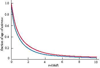

omnius said:
If H is indeed a variable factor, where's the graph?
This is actually really easy to answer. The Friedmann equation gives H as a function of scale factor. It is, roughly
[tex]H^2 = H_0^2(0.3a^{-3} + 10^{-4}a^{-4} + 0.7)[/tex]
Where H_0 is the Hubble constant today, and a is the scale factor (1 today).
Clearly taking it to be constant is not a good starting point, because it blows up quickly as a->0.
Thanks to all for the charts and explanations - what I have been pondering is indeed the scale factor and is pretty aggressively addressed, though I'm sad that it's apparently one of those "hotly contested" areas, given that it is so intertwined with Omega, something we're not "sure" about yet (in the bayesian sense).
http://www.astro.ucla.edu/~wright/cosmo_03.htm
Let me ask a comparative question based on these curves. If accumulated appropriately in any of the three cases (Omega<1, Omega=1, Omega>1), the scale factor contributes some expected size of the universe. Is this greater, less than, or equal to the observed size... or am I still missing the concept here? For example, consider:

Look at the same graph here:"[URL (scroll at the middle of page), and look at the curve OmegaM = 0.3, OmegaLambda= 0.7. That it is what we currently believe is the right one.
Edit: It is same as magenta curve at Ned Wright's pages.
