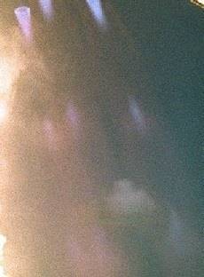

I am going to inaugurate the "What is happening here?" post series. I am interested on knowing what is happening physically in some aspects of flow around aircrafts. And surely, due to the high level of the co-forum-ers people :thumbs_up , you could provide me an answer, if you want of course, and discuss the reasons.
First of all, please open the attached file *.jpg. It shows the exhaust zone of the Shuttle at launch.
Why does it appear that blue colour?. All of us know that it is inside the combustion chamber where the flame and chemical reaction takes place. So that, what do you think is that?. I think it cannot be a detached flame. It is too outside to be a combustor's flame. It is a singular effect that is puzzling me. Surely it has to do with shocks waves interactions at the outlet.
We have seen it a lot of times in TV, but in particular I'm not able to explain it.
Just to add my ignorance to the pool...
The main engines burn hydrogen/oxygen, and hydrogen burns with a colorless flame. So, the blue color can't be from the flame of the burning fuel.
Maybe it is atmospheric nitrogen ignited by the heat and pressure of the engine exhaust.
I think its the air itself that is emitting the blue'ish color. Since hot objects emit color when they cool off - white being the hottest, and red being somewhat cooler, you can compare the color and get an approximate temperature of the region.

So the temperature in the blue cone area on the picture should be somewhere around 20,000 Kelvin
Hrmm. I'm not sure.
I do know that it isn't a 20,000K combustion. The temperature in the combustion chamber is less than 4,000K, and it can't get hotter than that without a secondary combustion. Even still, it wouldn't be all the way to 20,000 K. That's just too hot. My guess would be some sort of oxidation reaction instead of blackbody radiation (The burners on your gas stove aren't at 20,000 K, but they're blue).
I do know why the rings are so much smaller than the exhaust area. The SSME is designed for optimal performace at a fairly high altitude. That means that the flow is expanded much more than it needs to be for optimal performance at sea level. The pressure of the exhaust gases is much less than sea level at the nozzle exit. This causes the flow to be diverted inward.
Another thing to consider is the fuel to oxidizer ratio. See here. It lists the masswise O/F ratio of the SSME as 6.0, which means that stochiometrically there is more hydrogen than oxygen. This hydrogen at the high temperatures in the chamber will likely be dissociated into a monatomic state. It's possible that it's mixing with atmospheric CO2 to form methane or some other combustable gas which burns with the atmosphere's oxygen.

I just thought of a possibility:
It may be some ablative material which is burning. There are layers of an ablative insulation which lines the inside of the nozzle. This insulation melts away in high temperatures, protecting the structure beneath it. Carbon is a typical component of it. Methane may be associating in the exhaust flow (which is of a fairly low temperature by the point it gets to the nozzle exit... exit area to throat area is really big in the SSME) from that carbon and unburnt hydrogen fuel.
It's possible that there is a normal shock right where the fire starts. The shock would slow the flow down to subsonic speeds, increasing the local temperature (tremendously... almost to chamber temperature) in the process. That would account for the absence of fire anywhere higher than the exhaust plume, regardless of what is burning.
I don't know about the color of the nitrogen->oxides of nitrogen reaction.
Yet another possibility:
I don't know when in the liftoff this picture was taken (other than early). It's possible that we're looking at a unburnt remains of the hypergolic fuels used to start the engine (MMH/N204, IIRC).
I believe that what we are seeing are the tips of the "shock diamonds". These are apparent in many jet engines when exhaust velocity is supersonic.

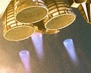

I've got another useful image over here. Take a look if you want. Here this zone is viewed better.
Don't know if this is usefull, but I've noticed that the cone-shaped blue areas in the first pic originally form as full, tear-drop shapes that go from the engine nozzle openeing all the way back to the point. It is only after a second or two that the area of discoloration progresses backward to the "tips" of these cones and dissappears altogether. Could this mean that we are seeing the incineration of the air behind the engine, or perhaps dust particles and impurities in the air? Seems unlikely, now that I say it, since such gasseus and particulate matter would blow out of the way much more quickly than the "blue zone" moves.
In that case, LURCH:
My official guess is that the blue cone is formed by the hypergolics being burned to start the H/O reaction.
But this hypergolics do not last forever. The time during the combustion of this hypergolics must be negligible compared with the total ignition time. Is a casuality that all images I've found have this blue cone?
I will try to read about that, but in my opinion the suggestion of H2 re-burning is the most plausible cause.
Lurch, was this to what you were referring to in the last post? (see the bottom image)
http://www.engineeringatboeing.com/articles/plume.html
"The exhaust species from a highly efficient oxygen/hydrogen propellant engine, such as the SSME, are primarily water vapor (H2O) and a small amount of residual hydrogen (H) and hydroxide (OH). The flame seen is the byproduct of both thermal and chemiluminescent excitation processes occurring in the main combustion chamber and continuing out the nozzle exit.
The radiated energy from the hot plume is predominantly the blackbody radiation from water vapor emission bands throughout the infrared wave-lengths, while the OH molecules radiate strongly in the near ultraviolet. "
Thank you. Your link is very useful. Now, you have given off all my doubts. :biggrin:
