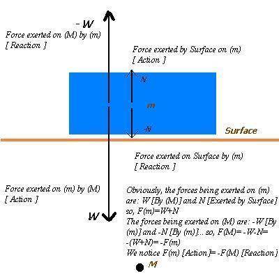

now i got like two theories.. the first that joyful presented and which i understand that there was really a misconception... but u, jdstokes, i didn't understand urs because it appeared to me like there were three forces, the first that the mass exerts an equal and opposite reaction force on the Earth's centre of mass, the second that the Earth is exerting on body (W)... the third which is the force that's applied to surface (normal force)... so please i want u to come again explaining more to me :smile:
because i surely got u wrong...

There are two forces acting on each of two bodies---four forces in total. The gravitational field exerts a force [itex]\mathbf{W}[/itex] on the mass [itex]m[/itex]. Likewise, [itex]m[/itex] exerts an equal and opposite reaction force [itex]-\mathbf{W}[/itex] on the Earth mass [itex]M[/itex]. In addition, the surface of the Earth (or table or whatever) exerts a normal force [itex]\mathbf{N}[/itex] on the surface of [itex]m[/itex], which exerts an equal and opposite force [itex]-\mathbf{N}[/itex] on the surface of the earth. So the nett force on [itex]m[/itex] is [itex]\Sigma\mathbf{F} = \mathbf{N} - \mathbf{W} =0[/itex] and the nett force on [itex]M[/itex] is [itex]\Sigma\mathbf{F} = \mathbf{W} - \mathbf{N} =0[/itex].
Thx jdstokes for helping me to clear up this misconception.
well, after trying hard to analyze the forces the way u explained to me i think ur mistaken when
u were saying that net force acting on (m) is (N - W) because the force (-W) is acting on earth
mass (M) not (m), and so as the other net force formula... anyway i tried to figure it out with
a sketch which is attached so i hope u take a deep look at it because i had a conclusion written on
the down-right corner of the sketch... NOTE: wherever i mention F(m), it means the net force
acting on (m)...
believe me,,, i really want to know the truth of this whole thing so please help! so just
tell me if it's right or wrong... if wrong, please correct me...
but i understand that u ment by N-W and W-N to clarify the opposite vectors, isn't that right?

Finally, you got it right.
magnitudes vs vectors
I think you are confusing yourself with plus and minus signs and directions.
And your diagram is oddly drawn. Why does it show W and "-W" both acting on m? And N and "-N" both acting on m? That makes no sense.
What are the forces on m? First we have its weight W (actor: the earth) pulling down. (The reaction force is the mass m pulling the Earth up.) Note that W is just the magnitude of the weight: the direction is downward.
Another force on m is the normal force N pushing m up (actor: the surface). (The reaction force is the mass pushing down on the surface.) Again note that N is the magnitude of the normal force: the direction of the force on m is upward.
Treating W and N as positive numbers (they are just magnitudes of those forces), and choosing up to be the positive direction, the net force on m is: [itex]F_{net} = N - W[/itex].
Of course, if you represented the normal force on m with the vector [itex]\vec{N}[/itex], and the weight of m with the vector [itex]\vec{W}[/itex], then you could say that [itex]\vec{F_{net}} = \vec{N} + \vec{W}[/itex].
WELL, GUYS, I CAN'T BELIEVE I MADE IT...
but i got to tell you doc that's how i studied it in books... i believe in that now that they r so odd but how should it be?
in other words, please can u show me how could i draw them?
after thati can rest in peace
You're quite correct ballooza, I stuffed up the signs. The vector equations should be [itex]\Sigma\mathbf{F} = \mathbf{N} + \mathbf{W}[/itex] for [itex]m[/itex] and [itex]\Sigma\mathbf{F} = -(\mathbf{N} + \mathbf{W})[/itex] for [itex]M[/itex]. Your diagram should have [itex]\mathbf{N}[/itex] and [itex]-\mathbf{N}[/itex] drawn in opposite directions with their tails centred at the interface of the block and the Earth. [itex]\mathbf{W}[/itex] should originate from the block's centre of mass and point downward, whereas [itex]-\mathbf{W}[/itex] should point up, originating from the Earth's centre of mass. I agree the signs are confusing. If you understand why this drawing is so, then you have got it.
Just make sure you know which direction you are taking as positive, the negative signs on the formula is trivial.
thank u people... i got it, but I'm going to make another sketch to correct those vectors, but i'll consider that vectors of forces start from the point of the centre mass of the body, if u know what i mean.. but i might be late because I'm very busy these days... so don't wait much... but i'll come again this week..
thanx again
