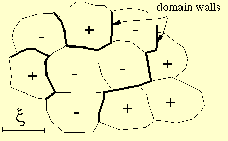

Diagrams like the one on http://www.damtp.cam.ac.uk/research/gr/public/cs_top.html seem to suggest the structure of the different domains is something like bubbles in foam, and each bubble has a center:
Why do you say they wouldn't have centers? Relative to whatever cosmological coordinate system we find most natural, can't we find the distance between any point inside the domain and any point on the domain wall? There might be different ways to define the "center" of an irregular shape, but we could pick some simple definition, like the point inside the domain that has the largest distance to the closest point on the domain wall...
Diagrams like the one on this page seem to suggest the structure of the different domains is something like bubbles in foam, and each bubble has a center:
It's not that easy...
Your picture looks like there was some universal time, common for all domains. This is not correct. In domains time flows "inside", that means near the wall the time is near 0 and in the center it is a big number. Actually, the point in the center of a domain corresponds to time infinity.
Domain wall is not something static, it rather moves at the speed of light for any observer.
Also, each domain does expand, so each point of it is equivalent.
Maybe it is possible, but I think the line connecting two points from different domains would have to go through singular points, so it would be hard to define its length.
