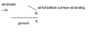

I don't remind well what was the ground effect. I think it provides with an additional lift force to the aero-plane, isn't it?. If so, it has an explanation with Fluid Mech. theory. To be honest I'm not able to explain it well using mathematical tools. Maybe, the airstream which flows onto the aircraft has the same behaviour like oil inside a journal bearing. This is a typical viscous flow at low speeds, such the aircraft landing process. The oil inside the journal bearing provides it with a lifting force when it passes through the narrowest gap section.
If you are not agree employing viscous approaching with this case, then I have a contradiction to discuss. Let's yield high #Reynolds and a very low #Mach. Then incompressible Bernoulli equation governs this process. See the figure below attached I've tried to draw, please.
Thus, the air passing through the section A-B must experiment a significant increasing of velocity, due to at low #Mach [tex]\rho[/tex] is almost constant, and section is shortened.
According to Bernoulli equation, static pressure must be smaller in A-B section as the flow is accelerated, so the lift force is decreased.
What is going wrong?. I don't know.

Can you explain that second reason?. I mean, give a mathematical reason for what are you saying. I've tried to explain it above, but I've reach a paradox using bernoulli equation. I'm wrong, but I don't know where.

I don't agree. Perhaps this enhances the top air stream being deflected upwards and creating a downwards force. But it is not what is called ground effect. F1 cars have half of a convergent-diverging nozzle at their bottom. The proper F1 bottom structure is curved like the narrower part of the half part of a convergent-divergent nozzle. I mean, like this:
-------\____________/------- F1 bottom
-----------------------------ground
Here, a narrower section accelerates the flow, creating a force downwards over the F1 car. Hey! can you see this? the question is: what is the difference between this analysis and the other for airfoils?. They have opposite effects but I see the same thing.
Change the label "F1 bottom" by "airfoil bottom", what happens?

Actually, I was under a common misconception here. See http://www.aa.washington.edu/faculty/eberhardt/lift.htm site.
Many pilots mistakenly believe that ground effect is the result of air being compressed between the wing and the ground.
To understand ground effect it is necessary to look again at the upwash. Notice in Figure 15 that the air bends up from its horizontal flow to form the upwash. Newton's first law says that there must be a force acting on the air to bend it. Since the air is bent up the force must be up as shown by the arrow. Newton's third laws says that there is an equal and opposite force on the wing which is down. The result is that the upwash increases the load on the wing. To compensate for this increased load, the wing must fly at a greater angle of attack, and thus a greater induced power. As the wing approaches the ground the circulation below the wing is inhibited. As shown in Figure 16, there is a reduction in the upwash and in the additional loading on the wing caused by the upwash. To compensate, the angle of attack is reduced and so is the induced power. The wing becomes more efficient.
The description is a little tough, but it sounds like the ground inhibits airflow under the wing, causing more to flow over the top.

You're right. http://www.usairnet.com/encyclopedia/Ground_effects.html is a link:
The basic idea is to create a volume of low pressure underneath the car, which sucks the car to the road. Naturally, to maximize the force one wants the maximal volume at the minimal pressure. Racing car designers have achieved low pressure in two ways: first, by using a fan to suck air out of the cavity; second, to design the underside of the car as an inverted aerofoil so that large amounts of incoming air are accelerated through a narrow slot between the car and the ground, lowering pressure by Bernoulli's principle.
