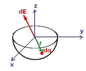

Draw a picture something like the attached one. You need to get the electric field at the centre of the sphere. For a surface element dA at a given position (θ,φ) write dE, the contribution of the charge on dA to the vector of the electric field at the centre. Write all components of dE in terms of the angles θ and φ. Integrate for the half sphere.

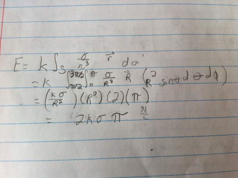

I think I see what you are saying. Am I on the right track?

Not quite... The electric field is a vector, and dE, the contribution of a surface element dA is antiparallel to the radius vector. You can see that the horizontal component of E cancels because of symmetry, but you get the same if you integrate the x ad y components of dE.
The resultant field has only z component. Write down the z component of dE and integrate from 0 to 2pi with respect to φ and from pi/2 to pi with respect to Θ.

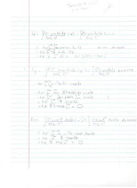

Ok I think I am very close. I am getting, what I hope is, the correct answer. However, I am off by a factor of -1 at the end. Did I mess up on the first step where I substituted for
-z_prime? I put Rcos(theta), but is it supposed to be -Rcos(theta). Thanks again.

Yup, that's your error.
Ok so I should add a negative sign in front of my z_prime, x_prime, and y_prime terms on all three equations. For the bottom two, it won't change it from 0, and for the top one, it will make it correct? I think I got it. Right?
