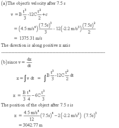

An object starts from rest and has an acceleration given by
a = Bt^2 − 1/2Ct, where B = 4.5 m/s^4 and C = −2.2 m/s^3
(1) What is the object's velocity after 7.5 s? (Indicate the direction with the sign of your answer.)
(2) How far has the object moved after t = 7.5 s?
v=at
I integrated the equation its not coming out right
what am i doing wrong?
If someone can kindly explain.
Here is the attachment
Hint
v=at is valid if acceleration is not time dependent (i.e. it is constant)
So, I am using the wrong equation? What equation should i use?
you have to integrate the equation not differentiate
So i have to integrate a= Bt^2- 1/2Ct?
Do i substitute the answer in equation v=at? Or i can't use that equation at all since a is time dependent.
Can you show some work so I have a better idea?
We derive the equation v=u+at assuming that acceleration is constant.
here acceleration is time dependent
dv/dt = a
dv=adt
substitute a with the equation you have
integrate both sides of the equation with limits 0 to v and 0 to t respectively
after this you get an equation of v as a funtion of time.
substitute t=7.5s in this equation to get velocity at that time.
