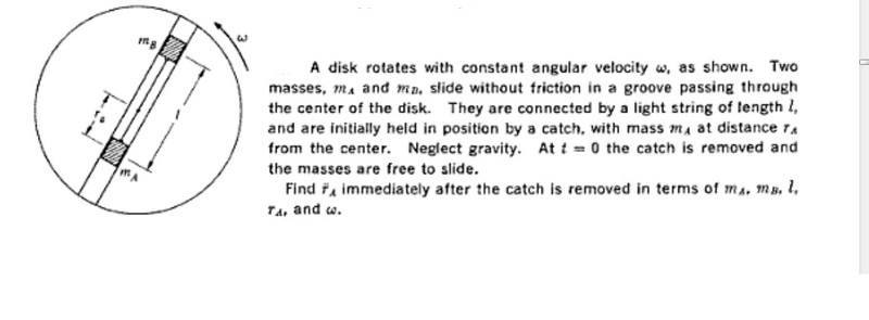

i am facing problem in attempting the peoblem attached below
if i work in the non inertial frame (the rotating)
shouldn't the acceleration of m_a after the catch is removed
be simply =[tex]\omega[/tex]2ra
thanks in advance
The masses are connected with a rope. The centrifugal forces on them work in opposite direction. If [itex]m_a = m_b[/itex] and [itex]l = 2 r_a[/itex] The acceleration is obviously 0.
