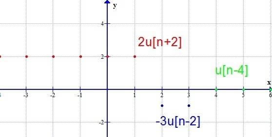

Hi there,
This is a different question I tried.
The signal is given as x[n] = 2u[n+2] - 3u[n-2] +u[n-4], and it has values x[-2]=2, x[2]=-1 and x[4]=0. True or false?
I think it's false cause If I plug in all the x in each case ie, -2, 2 and 4, into the signal, than I get 3 different values for u.
For x[-2]; u = 1/3
For x[ 2]; u = -1/6
For x[ 4]; u = 0
Is that correct way to do this question?
Help guys!
Thanks
This is not homework!

you have to draw x(n) first. Then apply what they gave you. All are true
Ok so today I did something called Convolution Sum, and my lecture showed me how to draw graphs with u[n], and for the question above I was able to come up with a graph.
Is this correct?
