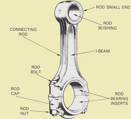

My bet is detonation ..but here are some things to think over..
The connecting rod connects the pistons to the crankshaft. It converts the linear motion of the pistons to the rotary motion of the crankshaft. On every stroke, the connecting rod is stretched and compressed. This pressure, plus other factors, can cause the connecting rod to break.
The number one cause of failure is fasteners followed by rod breakage. Fasteners are the weakest link of the con rod. There are two types of fasteners. Through bolts and cap screws. The through bolt requires a nut. a flat must be machined into both the rod and end cap and this breeds stress risers. A capscrew threads into the big end and helps strengthen the whole cap/rod scene.
As I said above , Fatigue is the main cause of broken connecting rods. The constant compression during the power stroke and stretching during the exhaust stroke, over thousands of times a minute, eventually wears the metal out and it becomes brittle and finally breaks at the inclusions or stress risers on the rod surface, These are caused by the forging process..its like putting a nick or notch on a coat hanger and bending it until it breaks.If the oil is low or dirty it can speed up this process. Running the engine hot can also speed up the process.

Further reading = see
Tension and Compression in Connecting Rods , A Failure Analysis by Luke Schreier , EM 325H , April 26, 1999
