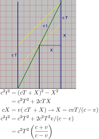

As I've said, it doesn't apply to the twin paradox. The differential ageing is because the proper times of worldlines may be different, thus the clocks traveling those worldlines may have different elapsed times.
In order to calculate the relativistic doppler formula, it is necessary to use the proper time, not the other way round. The space-time diagram I've attached shows how it's done geometrically, without any assumptions except the proper time formula. 'cT' and 'ct' are proper lengths.
