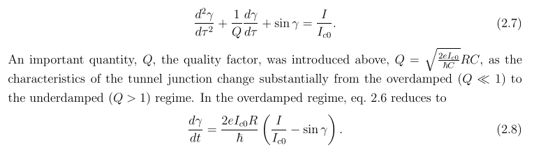

I deleted the attachement, since I tried to post a more abstract case, which isn't related to any physical problem.
The original problem can be found in the following screenshot:
(please not: not eqn 2.6 should reduce to 2.8. in fact, 2.7 should reduce to 2.8 )
which is from page 13 of this pdf-file: http://www.weizmann.ac.il/condmat/superc/theses_files/8.pdf

If I throw away the second derivative and solve for the first derivative, I don't get equation (2.8).
So it seems like something more is going on here.
Unfortunately I'll have to go out for an hour or so, but I will take a better look when I get back and see if I can understand what's going on here on a purely mathematical basis.
I now got equation (2.8), initially I missed that they switched back to a t-derivative rather than [itex]\tau[/itex]-derivative.
Indeed the only approximation they make is ignoring the [tex]\frac{d^2\gamma}{d\tau^2}[/tex]
Let's follow through with the second derivative intact: we start from
[tex]\frac{d^2\gamma}{d\tau^2} + \frac{1}{Q} \frac{d\gamma}{d\tau} + \sin\gamma = \frac{I}{I_0}[/tex]
Since [itex]\tau = Q \frac{t}{RC}[/itex],
[tex]\frac{d\gamma}{d\tau} = \frac{d\gamma}{dt} \frac{dt}{d\tau} = \frac{RC}{Q} \frac{d\gamma}{dt}[/tex]
and
[tex]\frac{d^2\gamma}{d\tau} = \left(\frac{RC}{Q}\right)^2 \frac{d^2\gamma}{dt^2}.[/tex]
The equation thus becomes
[tex]\left( \frac{RC}{Q} \right)^2 \frac{d^2\gamma}{dt^2} + \frac{RC}{Q^2} \frac{d\gamma}{dt} = \frac{I}{I_0} - \sin\gamma.[/tex]
Isolating the first derivative,
[tex]\frac{d\gamma}{dt} = \frac{Q^2}{R C} \left( \frac{I}{I_0} - \sin\gamma \right) - Q \frac{d^2\gamma}{dt^2}.[/tex]
So the question is basically: why can we neglect Q with respect to Q²/RC?
In other words, why is
[tex]\sqrt{\frac{2eI_0}{\hbar C}} R C \ll \frac{2eI_0}{\hbar C} (RC)^2 / RC[/tex]
That is,
[tex]1 \ll \sqrt{\frac{2eI_0}{\hbar C}}[/tex]
So apparently, there is the silent assumption that the RC time is very short here, i.e. RC << Q << 1.
How sensible this is I cannot tell you, I can do the math but I don't know much about Josephson junctions.
