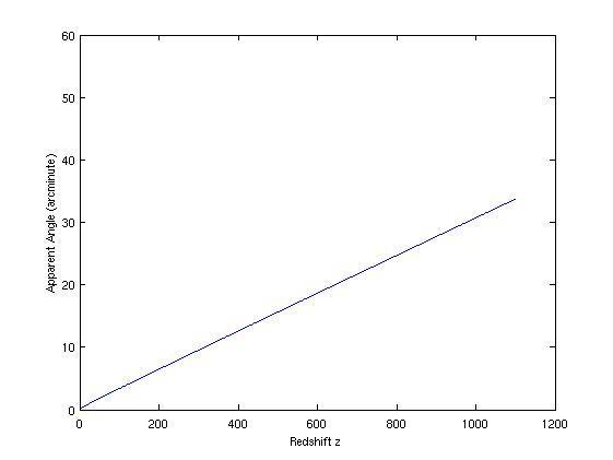

Hello,
i wrote a Matlab program which calculate the apparent angle of an anisotropy with a size equal to "380.000 light-years" , i.e "0.1166 Mpc".
For this, i have used the following equation defining the apparent angle ( in arcminute unit) as a function of the redshift "z" with "Danisotropy=size of the anisotropy" :
[tex]\theta= \dfrac{180*60}{\pi}\,D_{anisotropy}\,\big[\dfrac{c}{H_{0}\,(1+z)} \ ,\int_{z_{begin}}^{z} \,(\Omega_{m}\,(1+z)^{3}+\Omega_{\Lambda}+\Omega_{k}\,(1+z)^{2})^{-1/2}\,dz\big]^{-1}[/tex]
For [tex]\Omega_{m}=0.3[/tex] and [tex]\Omega_{\Lambda}=0.7[/tex], i get the figure in attachment. For "z=1100", I have an angle apparent equal to about 30 arcminutes for Danisotropy=380.000 ly , i.e 0.5 degrees.
This value is relatively quite far from the first peak in CMB power spectrum which is localized at "l=200", i.e "theta= 1 degree".
Does the relation between multipole "l" and "theta" angle take the form : "theta(°)=200/l" ?
If it does, then my calculation is the value of one of the others peaks which are localized for smaller angles ?
If anyone could explain me to which peak corresponds this result,
Thanks in advance.

Why did you pick out 380,000 light years?
P.S. This calculation looks correct to me. I think there's just an issue with your interpretation.

fab13 said:
I thought this anisotrpy size (380,000 ly) seemed to be typical because i saw a conference where the speaker told us to put this size .
Which peak am I supposed to find with my previous calculation of theta at z=1100 ? (the first peak at L=200, the second one at L=500, ... ?
How to choose a good value for this anisotropy size to find a value corresponding to this peak ?
Thanks in advance.
Might be easier to take the angular size and convert that to a length scale. You'll get a number about twice that.
Which should make sense: the CMB was emitted when the universe was around 380,000 years old or so. So an initial perturbation would have been able to expand in one direction some 380,000 light years, and 380,000 light years in the other direction, leading to a peak-to-peak distance of about 760,000 light years (very roughly).
Granted, one would have to investigate the precise nature of the expansion in those first 380,000 years to get a good handle as to why the sound horizon works out to be close to this intuitive calculation.
Yes, taking an anisotropiy size equal to 760.000 ly, i find with this calculation the double of my previous result , i.e an angle equal to 60 arcminutes, so 1°. This corresponds roughly to the first "accoustic peak" in cmb power spectrum (l =200).
