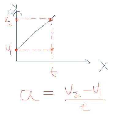

can someone help me graph this?
http://www.physics.drexel.edu/courses/Physics-152/probgraph.gif
I can understand that, since the velocity is changing, the x versus t graph should not be a straight line, that it is curved, but that's about all I can figure out.
I don't have a textbook, because the bookstore is backordered on all of them, plus this was not covered in the first lecture, so all I can figure out is that it's some curve...
Please help me... :confused:

what does it ask you to find? accelaration or distance?
accelaration is speed/ time and distance is speed * time..
the question was this exactly...
"7 Chapter 2, Question 22,and plot an x vs t graph of the motion."
so I mean, the directions aren't that helpful, plot an x vs t graph of the motion
the book I have does have a drawing of a x versus t graph, but it derives it from already having acceleration... and used the equation
x=Initial Velocity x Time + 1/2 x Acceleration x Time^2

from the graph above acceleration= [V(final)-V(initial)]/[t(final)-t(initial)]
in other words a= (V2-V1)/(t2-t1)
initial velocity= 15m/s
just graph velocity*time from the given graph above
so it's (10-15)/(120-0) to get acceleration of -1/24
and I just graph
15x + (1/2)(-1/24)x^2? all I got was a straight line
couldn't the final velocity be any point along the line in the above graph? see that's what's confusing me the most, that there aren't any concrete numbers that I can see to use
I mean, for the first part of the graph, I can see yes, the equation should be
y=1/2x+15
because the slope is 1/2 and picking a point (10,20) plugging that in, got me the y intercept... but that just happened to work out
but that y intercept equation, I don't see how it helps, it just gives me an equation for a line I already saw, but not even the whole line...
d= v0xt-0.5 x a x t is good for uniform acceleration
so use d= (v2-v1)* 0.5 (t2-t1)
so
v2=20
v1=12
t2=10
t1=0
d1=0.5*(20-12)*(10-0)=40
so you graph (10,40)

v2=25
v1=20
t2=20
t1=10
d2=0.5*(25-20)*(20-10)=25
total distance= d1+d2=40+25=65
graph (20,65)
and so on...
I hope this is right otherwise I'll go insane.
