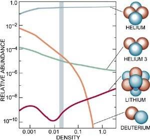

The other strike against MACHOs is that the Big Bang Nucleosynthesis (BBN) models say pretty conclusively that dark matter cannot be made up of ordinary matter(protons and neutrons). If it were, then during the Big Bang much more Helium would have been produced through nuclear fusion than we observe.

Quote Quote by phyzguy View Post
I think the big constraint is deuterium. See
http://astro.berkeley.edu/~mwhite/darkmatter/bbn.html
Helium-4 tends to be rather insensitive to the initial baryon concentration, whereas if you have lots of baryons then the deuterium burns out a lot faster, which means you have less of it.
And then there is galaxy correlations and CMB fluctuations (i.e. lots of nails in the coffin).

Quote Quote by twofish-quant View Post
Your right of course. I oversimplified - my bad. Here's a nice graph showing the impact of more baryonic matter on the elemental abundances. As you said, the Deuterium concentration crashes quickly if the dark matter were baryonic.
