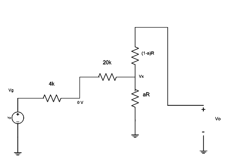

The op-amp in the circuit shown is ideal (please see attachment). The adjustable resistor RΔ has a maximum value of 160 kΩ and α is restricted to the range of 0.22 ≤ α ≤ 0.7.
(a) Calculate the range of vo if vg = 40 mV
(b) If α is not restricted, at what value of α will the op amp saturate?
for a difference amplifier: vo = -(Rf/Ri)vin
Firstly, I don't understand how the adjustable resistor functions in this circuit.
My interpretation is that the resistance ranges from a minimum of 0.22(160 kΩ / 0.7)
to a maximum of 160 kΩ (given).
PART A:
for maximum gain, Rf is maximized
so Rf = 20k + 160k = 180k
then vo = -(180/4)(40mV) = -1.8 V, which is not the right answer
for minimum gain, Rf = 20k + 50.29k = 70.29k
so vo = -(70.29/4)(40mV) = -0.703 V, which is again not the right answer
PART B:
for saturation, we would require a gain: A = 12V/40mV = 300
so Rf should be 300*4 kΩ = 1200 kΩ
then the variable resistor should provide a resistance of 1180 kΩ
how is this even possible, if the maximum resistance is way smaller than this value?
I must be misunderstanding how the resistor works, so I would appreciate any help
Thanks in advance.

I believe they are saying that the pot can be adjusted from 0.22 to 0.7 of its full scale setting. And I don't think you can just use the standard inverting amplifier equation, not with that grounded pot sitting in there. I'd write out the new KCL equations, with a new node at the wiper of the pot. What equation do you get now for the transfer function?
And when they remove the restrictions on the pot, that just means that it can go all the way to the ends, with the wiper at 0 Ohms or up at 160 kOhms.

The attachment is a quick sketch of a section of the circuit with my variables labelled.
Here's my KCL equations:
1)
Vg/4000 = -Vx/20000
so Vx = -5Vg
2)
Vx/(aR) = (Vo-Vx)/(1-a)R
(1-a)Vx = a(Vo-Vx)
Vo = Vx/a = -5Vg/a
PART A:
I used a = 0.22, then a = 0.7 to get the range of Vo
PART B:
I set Vo = -12 = -5Vg/a
and got a = 0.0167
