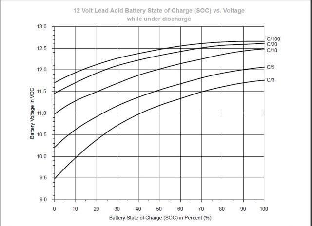

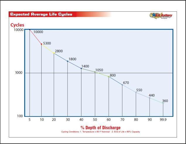

For lead-acid batteries, by considering the slope of the first graph as a function of the percent discharge for each charge cycle, it is seen to be most efficient to fully charge the battery after each use and to minimize the percent discharge. Note that a car battery would typically discharge no more 5% before recharging.
There is the additional issue of battery voltage as a function of the percent discharge and the load. Considering the second graph [Source: Home Power #36 • August / September 1993], as the percent charge decreases, the voltage of the battery is reduced resulting in less power per percent drop in charge [an increasingly negative slope as the charge approaches zero].
A rule of thumb in industry is that you never want to discharge a lead-acid battery more than 50%. There is the additional concern that low voltage can damage systems or fail to reach the minimum threshold for operation.
For the second graph, C is the battery capacity in amp-hours, where C/X represents the discharge rate. The different curves are determined in large part by Peukert's law.

Redbelly98 said:
That statement puzzles me, since a car battery is recharged every time the car is driven.
Yes, but automotive lead acid batteries are typically recharged from 90-90% capacity back to 100%. They are not intended for frequent deep discharges, as depleting the battery a few times by leaving the lights on while parked will demonstrate.
50% discharge would apply to the 'deep cycle' or 'marine' grade of lead acid batteries, i.e. lead acid with heavy duty anode plates. Automotive motor-starter batteries don't want to see less than ~90-95% charge (~5% discharge) as you first noted.
http://www.windsun.com/Batteries/Battery_FAQ.htm#Starting, Marine, and Deep-Cycle Batteries
True. However, I was referring to the limit, not the ideal or typical circumstance. Beyond 50% there is chance of permanent damage. This comes up for me when determining the absolute maximum run time [actually, volts vs load] before the system is automatically disabled. Deep cycle are good down to 50% in normal operations, but I have still been advised to never exceed that value in either case.
