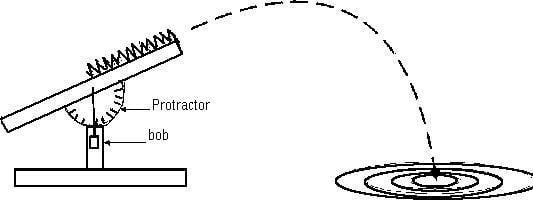

So what would be your version of the modified equation to figure out the distance to pull the spring back in terms of Δd, mass of the spring, Δy, k spring constant, and theta, the angle of launch.

The horizontal distance Δd from the target to the launcher is defined as the distance along the floor from the target to the base of the launcher (the launcher is always on the floor). This is in the x-direction only. The vertical distance Δy is the height of the target above the floor. Sometimes the target is elevated, sometimes it isn't. In the diagram, the target isn't elevated.
The length of the spring at equilibrium is 7.5 cm, but this shouldn't matter. All that matter is x, which is the amount of deformation.
The distance from the spring to the target doesn't change as the spring is pulled back. The front of the spring stays stationary. The distance from the centre of mass of the spring to the target changes as the spring is deformed, but this small distance is negligible.
Okay, if you want to ignore the change in the center of mass' position due to deformation, I'm okay with that if you are. :smile: It will make the math easier.
But before I let it drop, I just want you to realize that you are introducing a source of error into the math by doing so. Even in perfect conditions (ideal springs, launched in a vacuum, etc), it will cause the spring to be off target by an amount comparable to x (it also depends on Θ too). So if you calculate that x should be 4 cm, don't be surprised if the spring misses its target by a couple cm or so, even in the best of conditions.
But what you do need to do is estimate the spring's approximate center of mass in relation to the dot on the floor indicating where the base of the launcher is supposed to go. You need to find this displacement, in both the horizontal and vertical directions. Perhaps you can estimate this once, and use the same value for all launches. But you should at least measure it once.
All of the kinematics equations need to relate to the spring's center of mass. So you should have at least a rough idea of where it is in relation to the target.
What you are given is the displacement between the target and the base of the launcher. You will need to do is convert this to the displacement between the target and the spring's approximate center of mass. You can fit all this right into your spring stretching equation.

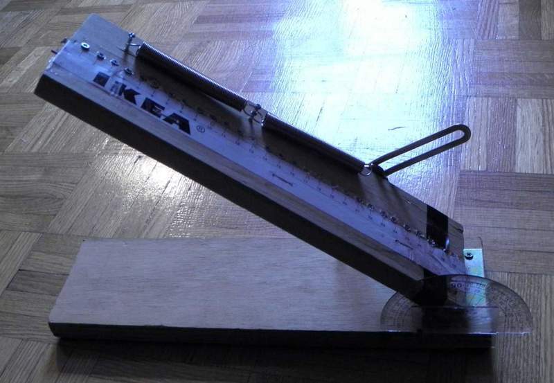

Below is a better diagram. Basically, the launcher is a flat piece of wood that hinges relative to the floor. There is no vertical rod. Therefore, the height of the spring is approximately 0.3sinΘ.
Also, y2 is the height of the target above the floor, which is the final height of the spring projectile. The expression is Δy = y2 - 0.3sinΘ, which I used to replace Δy in the equation. In the case that the target is on the floor and below the spring, Δy would be negative. In the case that the target is elevated and above the spring, Δy would be positive.
collinsmark said:
(And it might turn out that the difference in height of the spring due to the tilt Θ, is small enough to ignore. I mean we're already making a few approximations anyway. But that really depends on the design of the launcher, and how much error is acceptable.)
The launcher platform is quite long, so the height due to the tilt should be considered.

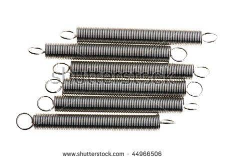

On the other hand, I hadn't even considered springs that are already at or near their maximum compression at equilibrium! Imagine a spring, starting from equilibrium, that you can stretch apart, but cannot compress (at least not very much, before reaching saturation).
(Image courtesy of this site: http://www.shutterstock.com/pic-44966506/stock-photo-object-on-white-tool-metal-spring.html"
That type of spring might change the center-of-mass kinetic energy ratio significantly. Essentially, what happens is that each loop on the spring hit's the adjacent loop at the moment the entire spring fully collapses, and it ends up being one big inelastic collision.

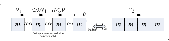

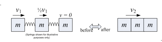

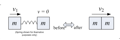

I did some fairly detailed calculations regarding the ratio of kinetic energy after vs the total kinetic energy before. (Normally, I would not just give these calculations away to the original poster of a thread, but you mentioned that your instructor is already recommending using a given value; and besides my calculations are a bit beyond most high-school physics anyway.)
Here is my model. In this model we are only concerned with the inelastic collisions themselves, and kinetic energies before and after the collisions. Nothing so far deals with spring characteristics (more on the below). Springs are modeled by distributed masses. Suffice it to say, that all the spring's potential energy is converted to the mass's kinetic energies immediately before the collisions (kinetic energy is not conserved after the collision however).
  • Number of masses (loops): n
  • Mass of a each loop: m
  • Velocity of tail end of the spring, immediately before collision: v1
  • Velocity of all loops (whole spring), immediately after the collision: v2
//////// Two mass example. ////////
Consider a "spring" simply modeled by a mass at the tail end, and an equal mass in front (at rest) before the collision.
Conservation of momentum:
[tex] mv_1 + 0mv_1 = (2m)v_2 [/tex]
[tex] v_2 = \frac{1}{2}v_1 [/tex]
Kinetic energy comparison:
[tex] \mathrm{before} \ \Leftrightarrow \ \mathrm{after} [/tex]
[tex] \frac{1}{2}mv_1^2 \ \Leftrightarrow \ \frac{1}{2}(2m) \left(\frac{1}{2}v_1 \right)^2 [/tex]
simplifying,
[tex] \frac{1}{2}mv_1^2 \ \Leftrightarrow \ \frac{1}{4}mv_1^2 [/tex]
[tex] \frac{(\mathrm{K.E. \ after})}{(\mathrm{K.E. \ before})} = \frac{1}{2} [/tex]
//////// Three mass example. ////////
[tex] mv_1 + m\left( \frac{1}{2} v_1 \right) = (3m)v_2 [/tex]
[tex] \frac{1}{2}mv_1^2 + \frac{1}{2}m \left( \frac{1}{2}v_1 \right)^2 \Leftrightarrow \frac{1}{2}(3m) \left(\frac{1}{2}v_1 \right)^2 [/tex]
simplifying,
[tex] \frac{1}{2}mv_1^2 + \frac{1}{8}mv_1^2 \ \Leftrightarrow \ \frac{3}{8}mv_1^2 [/tex]
[tex] \frac{5}{8}mv_1^2 \ \Leftrightarrow \ \frac{3}{8}mv_1^2 [/tex]
[tex] \frac{(\mathrm{K.E. \ after})}{(\mathrm{K.E. \ before})} = \frac{3}{5} [/tex]
//////// Four mass example. ////////
[tex] mv_1 + m\left( \frac{2}{3} v_1 \right) + m\left( \frac{1}{3} v_1 \right)= (4m)v_2 [/tex]
[tex] \frac{1}{2}mv_1^2 + \frac{1}{2}m \left( \frac{2}{3}v_1 \right)^2 + \frac{1}{2}m \left( \frac{1}{3}v_1 \right)^2 \ \Leftrightarrow \ \frac{1}{2}(4m) \left(\frac{1}{2}v_1 \right)^2 [/tex]
simplifying,
[tex] \frac{1}{2}mv_1^2 + \frac{1}{2}m\frac{4}{9}v_1^2 + \frac{1}{2}m\frac{1}{9}v_1^2 \ \Leftrightarrow \ \frac{1}{2}mv_1^2 [/tex]
[tex] \frac{7}{9}mv_1^2 \ \Leftrightarrow \ \frac{1}{2}mv_1^2 [/tex]
[tex] \frac{(\mathrm{K.E. \ after})}{(\mathrm{K.E. \ before})} = \frac{9}{14} [/tex]
My instructor isn't providing springs. The students are responsible for providing their own springs. The springs I'm using are identical to the springs in the second picture. The springs can't be compressed at equilibrium.
So I edited the equation assuming 3/4 of the elastic potential energy is converted into kinetic energy. I measured the k constant and the mass of the spring today. I tested the launcher out, and the equation proved to be surprisingly accurate. The launcher wasn't perfect, but there were many factors that could've caused inaccuracies.
I don't understand the part about applying hook's law to my type of spring. Isn't F = -k(x + x0) just the k constant times the change in the spring's length (deformation)?
I've attached the new equation and a picture of my launcher below.
Assuming no consideration of x0, your equation looks good to me. :approve:
