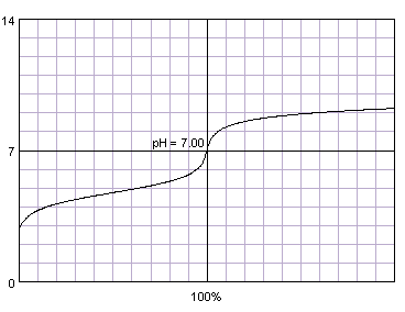

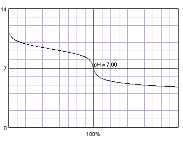

For all the first part it is hard to answer - you need to formulate the equations then it will be less vague and you will begin to see.
Your last sentence is fairly close and I think I said something related. If the pK's are close together it will be hard to find a suitable indicator, specially as these are themselves acids/bases, and if they are monobasic will change form no more steeply than what you are titrating. You will be able to see an inflection in the pH/acid or base added curve at equivalence. For acetic acid and ammonia for example, the pKa's are far enough apart you could find an indicator for in between.
Can be difficult. See titration curves - both solutions 0.1M.
Shameless plug: both curves generated and exported from BATE pH calculator with just a few clicks.

For acetic acid and ammonia K = 3x104, that's not small equilibrium constant.
But the really important thing is how fast does pH change around equivalence point. And I am not going to repeat the discussion that I linked to.

Large K yes, but obviously 104 is not enough. Difference between Ka and Kb is not a good indicator, Ka = Kb = 1 is a perfect combination of acid and base.
From your HAc-ammonia plots, there is no sudden change at all, you would need and indicator that changes right at pH 7
