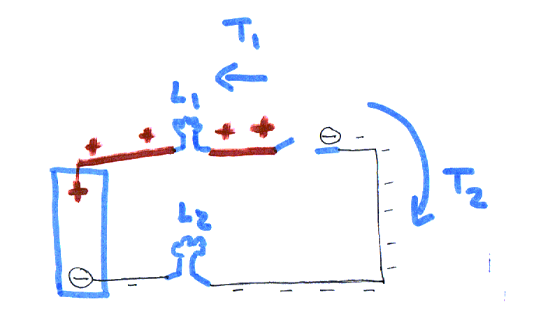

I have drawn a simple picture. To emphasise a point I have placed the lamps at exactly the same distance from the battery, but at obviously very different distances from the switch.
This is the situation when the switch is open. The switch contacts are shown in blue.
When the apparatus is first connected a very small current will flow for a short time until
all the wiring and lamps connected to the positive terminal (red) are at the same voltage as the +ve terminal.
all the wiring and lamps etc connected to the negative terminal (black) are at the same voltage as the -ve terminal.
I have drawn little + and - to show that this goes all the way round the circuit.
It also shows that the switch contacts are at different voltages.
When the switch is closed the contacts come together and cannot be at different voltages.
The equalisation of the voltages causes pulses or fronts or switching transients to move as I have shown.
The posh term is switching transient so I have labelled them T1 and T2.
As you can see, T2 has a lot further to go to reach lamp L2 than T1 has to reach lamp L1.
So L1 will light first.

I think i get it now, you have been very helpful, do have any book recommendations where these pulses are worked in detail? So i can put a nail in this (: thanks

I should mention that these transients are absorbed in the battery and do not appear again while the switch is closed.
After this a steady state appears, with current flowing one way only round the loop.
I'm sorry to tell you that transients are not dealt with further in any elementary textbook that I know.
Such books treat the situation where the switch is open
Jump past the transient condition
And proceed directly to the steady state condition with statements like
after a long time or after a steady state has been reached etc.
