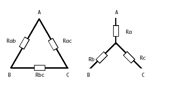

Three-phase transformer, 20/0.5 kV, dyn11. Not connected to the grid.
DC-resistance between two primary windings is measured to be 80 ohm. What is the DC-resistance of ONE primary coil
I thought I could just calculate Ra there, because I assume all the coils are identical?
Is the 20/0.5 kV info even needed here?
I assume the problem should be?
DC-resistance between two primary terminals is measured to be 80 ohm
Forget about d-y transformation.
Concentrate on the left figure, and deduce a formula for the total resistance seen from terminals A and B. And this formula equals (?). All winding resistences are equal.
isnt the total resistance of the triangle that 80 ohms? so resistance of one winding should then be 80/3? well apparently not because i don't get the right answer with that
As you said yourself, its not 80/3.
If all resistances had been connected in series, it would have been. But its not.
What is the formula for the total resistance seen from terminals A and B? Hint: One series connection and one parallell connection.
Draw a new figure if you don't see it.
aaah stupid me, that's right, the triangle confused me :D
I calculated (80*80 / 80+80) + 80 and got the right answer!
thanks very very much
