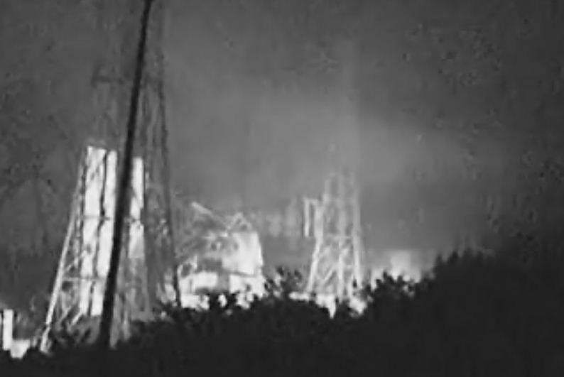

elektrownik said:
Something is bad, reactor 3 appear to by on fire
The current temperature is quite cool at ~11-12 Deg C and the dew point is also the same (100% relative humidity) Thus any warm water vapour from the spent fuel pools is going to change into fog. Thus doesn't look like a major issue to me.

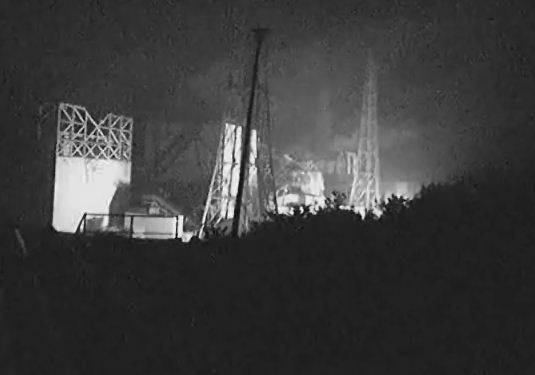

StrangeBeauty said:
Having observed the live cam for more than a week now, including during the time when the whole "#3 is on fire!11!" meme was going around the net, this doesn't look much different than previous nights. As previously mentioned, the marine layer effect enhances the appearance of the steam releases. I think tomorrow during the day things will look the same as yesterday. Relevant note is that yesterday there were, to my eye, significant continuing steam/smoke releases from #2 and #3.
Yes, please, let's not get into that again. If there is white smoke: steam = normal. Even grey/black smoke doesn't necessarily mean fire, could be concrete dust. If one can see flames, ok then we should be concerned, but only then.

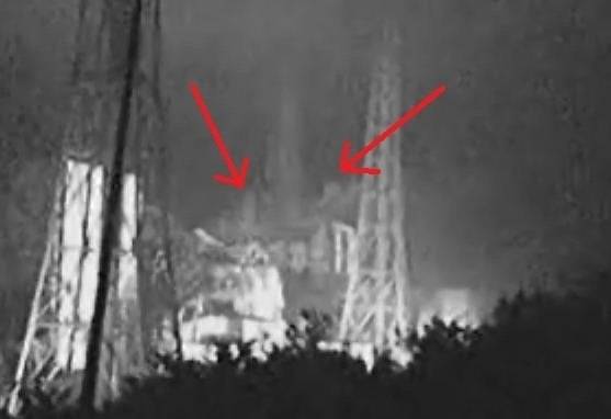

Astronuc said:
Ah thanks for that. I was thinking the other picture was looking from E or W, but wasn't sure.
If that is looking north at the DS pit then, the back wall is the structure between the DS pit and reactor cavity. They would not transfer fuel through there, but they would transfer the steam separator and possible steam dryer. The steam leakage then would seem to be coming from containment - possibly the reactor cavity.
This helicopter footage shows 3 sources of steam rising above unit 3 ( at 01:00 minutes) :
I've compared them to another layout of unit 3 to be able to pinpoint the locations :
http://img818.imageshack.us/img818/5710/reactor3overlayed1.jpg
The middle source is clearly separated from the left and right ones
Would that be the same location that you mention ?

pdObq said:
Would be interesting to know how far away the camera actually is. Outside of the evacuation zone?
unlurk said:
Punch 37°22'4.67"N 140°56'39.25"E into Google Earth and you'll be close.
@unlurk I beg to differ 37°17'52"N and 140°54'55"E
The camera is the same camera that recorded the explosion video, I worked it out some time ago. Below extract my post #5737 of 4 May
EDIT: That position I have given in post #5737 is wrong, OHL tower and reactor 1 do not line up as we can see in the live video feed, so back to google
[PLAIN]http://k.min.us/ikXR5A.jPG
The distance is 17km ! this point is 705 metres high http://watchizu.gsi.go.jp/watchizu.html?b=371803&l=1405507
[PLAIN]http://k.min.us/inr1us.JPG
[PLAIN]http://k.min.us/ikT2XW.jpg
In the explosion video you can see the same vertical line below the corner of unit 2,

mrcurious said:
Looks like it's coming in from south or southeast of #4. Could be a nightime marine layer. Having lived on the coast all my life I have seen these come in at dusk and they can lay pretty low to the ground and blow for hours. Prevailing winds at night reverse from inland to offshore due to the temperature drop on land vis a vis the ocean.
I see three quite distinct plumes from far side of #2, from #3 and from #4. 'T'aint natural.
