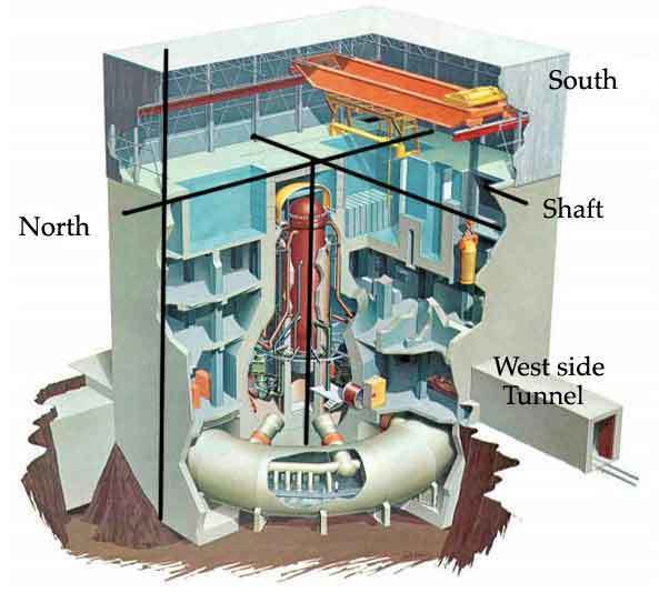

a better picture of the operating floor (I added a few comments)
[PLAIN]http://i.min.us/jjU8wO.jpg
  • #1,664
[PLAIN]http://i.min.us/jjU8wO.jpg[/QUOTE]
Thanks Fred.
It doesn't quite make sense. I see you've oriented it so that the containment vessel lid is in the north west, as it appears in reactor building 4. My understanding is that the SFP, reactor and equipment pool are lined up in the long-orientation of the building (~45 metres), that is north-south in reality, but east-west in your labeling.
The overhead crane straddles this long orientation i.e. bridges the short section of the building (~35 metres). This photo was probably taken from it.
Wasn't this from Fukushima Daiichi unit 5 or 6? As in not really relevant when talking about units 1, 2, 3 and four?

  • #1,671
The picture of unit (5 or 6 I have to check) was taken by Mitsuhiko Tanaka,engineer at Babcock Hitachi K.K., who helped design and supervise the manufacture of the steel pressure vessel for Tokyo Electric in 1975. on reactor n°4 . He was a weasel blower on a cover up during the manufacture of a faulty vessel structure on n°4.
According to M Tanaka the operating floor is the same on the other unit.

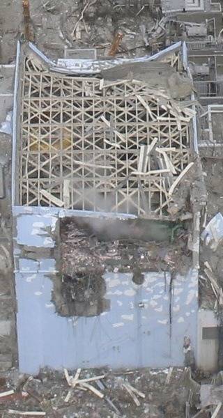

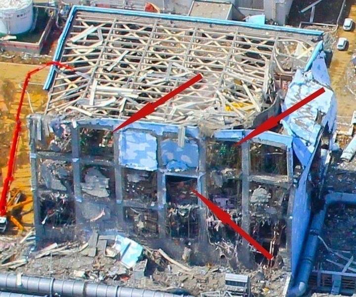

TCups said:
I believe this is may be the top of the gate for the fuel transfer chute of unit 3.
If that's the case, does that mean the void in front of the gate (ie closer to the camera) in that image is the SFP, which appears empty in the frames prior to your screengrab?
