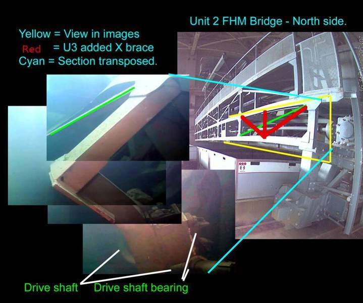

Quote by MadderDoc View Post
However note that '4' , photographed in a perpendicular to direction to '3', and at some distance from it, is the lower NW end of the north face of the bridge, which on the intact machine was mounted just above, and only a meter away from the track guide. Indeed the video of '4' shows the flange through which this corner was connected to the frame piece that is/was mounted on top of the track guide (albeit the mounting flange now looks sadly beaten up, de-bolted and without its partner)
The orientation marked "4" on that diagram is misleading.
In the video & still shot marked "4" we are viewing the vertical plane of the northern side of the bridge not the horizontal "top" of the bridge as the arrow tends to indicate. What we are seeing most of is the personnel "catwalk" with the driveshaft under it which is\was? bolted along the northern face of the FHM bridge proper.
In the video we only see a small glimpse of the main part of FHM bridge truss structure in the background, through the "catwalk" truss and possibly the FH Machine itself in the furthest background. It's very difficult to tell how "apart" the various sections of the whole FHM are but as Madder Doc mentioned, it's clear the heavy "end" piece shown in view "3" parted from this catwalk section in view "4".
Here is a quick diagram I made that didn't turn out that clear and features some terrible abuses of perspective & photoshop :)
Also, to be clear, it's comparing to Unit 2's FHM which is a little different but close enough for the purpose. There are just no decent images of the northern side of U3's FHM as it was.
PS - if this sort of post is getting just too off track then someone please say so - it is a bit of a messy thread at times and perhaps another thread for this sort of PCV hatch \ FHM \ Holes in floor type of discussion would be useful and make this sort of thing less disruptive to this thread? Perhaps rename & recycle the Unit 2 thread which is very quiet.

Quote by westfield View Post
I see what you mean, it also thought it could be more instructive. But the intent of the arrow to mislead is plausibly deniable. The arrow points as best it can to an object that is not visible in the drawing.
Neat. See that is more instructive! Attached is a suggestion for modification of the markup of unit 3 added x-beams, as I think they are at that end of the bridge.(Lest it might mislead into thinking you've seen more of the length of the bridge in that video, than you actually have.)

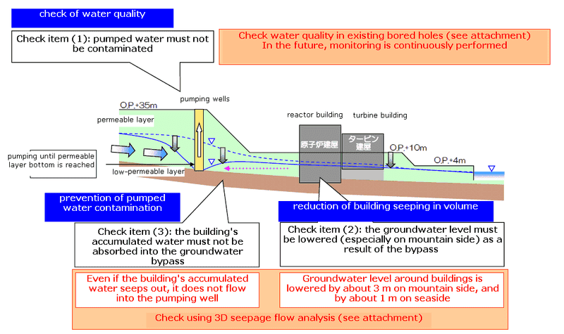

http://www.meti.go.jp/earthquake/nuc...120423_02n.pdf Plan to reduce volumes of groundwater seeping into units 1~4 buildings by groundwater bypass
Page 2/12
Outline
Measures dealing with liquid waste
Concerning liquid waste, in the future we shall perform the necessary studies mentioned below, and by performing the related countermeasures, it is intended not to simply release contaminated water into the sea.
①Radical measures against groundwater seeping into reactor buildings, etc., which is responsible for water increase.
②Measures for securing the upgrading of the decontamination capacity of the water decontamination facilities and for securing the stable running of those facilities including backup equipments to be used during breakdowns.
③Further installation of onshore equipments for contaminated water management
It must be noted that without the approval of concerned ministries, releases into the sea will not be performed.
It will continue in the future
As a radical measure against groundwater seeping into buildings, we are currently working for the recovery of the subdrains, but especially around the reactor buildings, the radiation dose being high, the degree of difficulty is high.
As an auxiliary measure in support of the subdrain, the following items are proposed:
The groundwater that flows down from the mountain side is to be pumped from a point upstream from the buildings (O.P. + 35 m level), and the watercourse is changed (groundwater bypass).
As a consequence of the groundwater bypass, the underground water level in the surroundings of the buildings (especially on the mountain side) is lowered, and the seeping volume into building basements is regulated.
The pumped water is bypassed to the sea using a special channel. Also, monitoring of the water quality is performed.

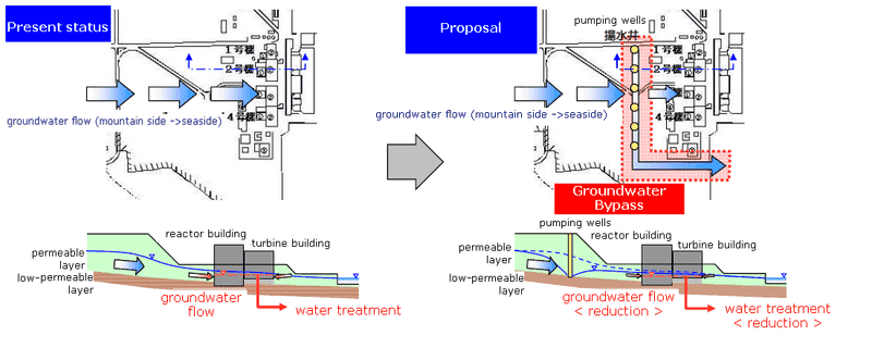

Page 3/12
Concept
Present status
Water mainly flows through the permeable layer from mountain side to seaside.
Part of the groundwater seeps into the buildings during its way to the sea → increase of accumulated water inside buildings
In order to regulate the volume of groundwater seeping into the buildings, the subdrain system is under restoration
Proposal
The groundwater that flows down from the mountain side is pumped from a point upstream from the buildings, and the underground water's watercourse is changed (groundwater bypass).
As before, the subdrain system restoration work continues

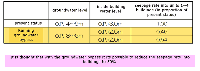

Page 5/12
Estimated effects
Assumption used to calculate effects : groundwater flows through building side walls as a consequence of the difference between the groundwater level and the inside building water level.

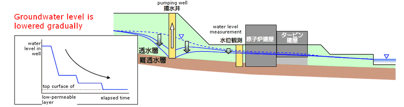

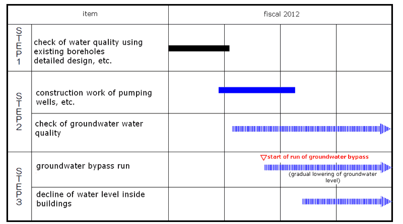

page 6/12
Implementation steps
【Step 1】 check of water quality using the existing 3 boreholes
【Step 2】 check of water quality in pumping wells (sequentially implemented)
【Step 3】 Lowering of groundwater level due to groundwater bypass (gradually implemented)
* As a result of operating gradually and of monitoring, implementation is done while checking water quality and groundwater level decline status etc.
* In accordance with the groundwater level decline, the lowering of the buildings' accumulated water levels is performed.
* As the lowering (recovery) of the water level surrounding buildings takes several months, water level management is carefully performed so that the buildings' accumulated water does not leak outside.
page 7/12
Abridged schedule
While checking water quality and groundwater level decline status, etc. , implementation is done gradually and carefully.

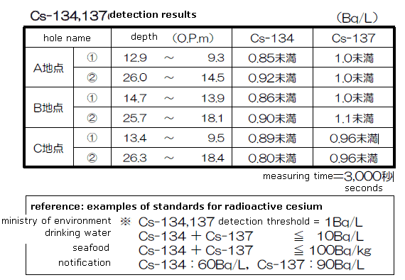

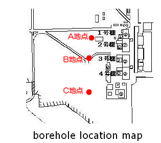

page 8/12
Attachment 1: Present status of groundwater water quality
*Cs-134 and Cs-137 are, as shown below, below 1 Bq/l when added together.
*In the future, continuous monitoring is planned
Analysed nuclides : all gamma nuclides, all alpha, all beta nuclides, tritium
Analysis results : all gamma nuclides, all alpha, all beta nuclides were below detection threshold
※ detection threshold : all alpha = 3.0 Bq/l, all beta=6.7 Bq/l, Cs-134, 137: see table below
※ radiation monitoring performed by ministry of environment for groundwater and public bodies of water
Tritium detection
* At A and C it is not detected. At B a low concentration (one thousandth of the notification standard) was detected.
* It is presumed that as a consequence of the nuclear plant accident, tritium was released as steam, and fell on the ground, and was absorbed.
* The beta rays generated by tritium have a low energy and the effect of exposure is small.
measuring time= 15,000 seconds, notification threshold= 60,000 [I guess it is Bq/l]

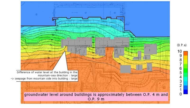

Attachment 2: Check of feasability (seapage flow analysis) (1)
Groundwater level status (subdrain shutdown)

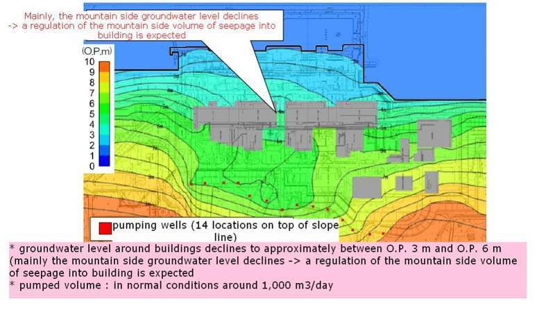

page 10/12
Attachment 3: Check of feasability (seapage flow analysis) (2)
Groundwater level and flow speed vector (subdrain shutdown, groundwater bypass in operation)

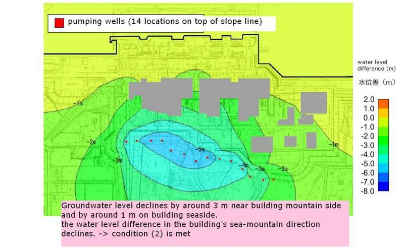

page 11/12
Attachment 4: Check of feasability (seapage flow analysis) (3)
Groundwater level decline
