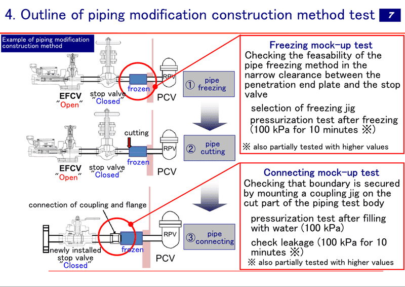

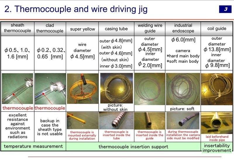

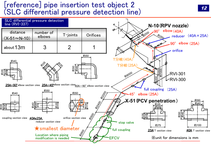

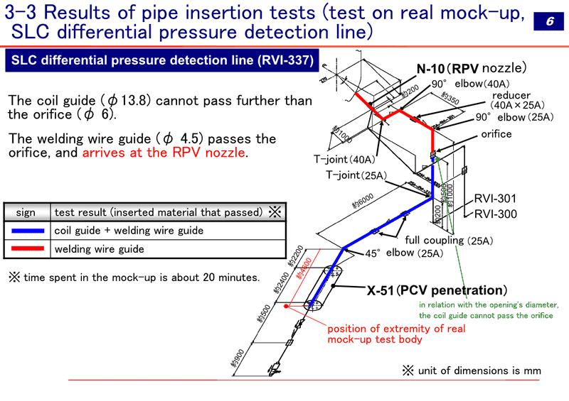

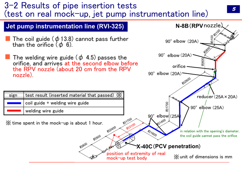

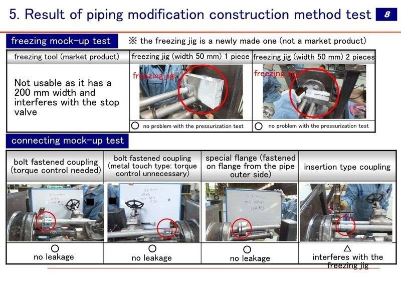

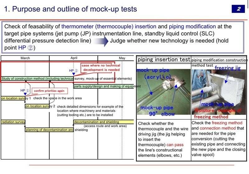

This is a document from one month ago :
Quote by tsutsuji View Post
The 5th mid long term meeting : http://www.meti.go.jp/earthquake/nuc...120423_02.html
3-1 Cooling by closed loop water injection
http://www.meti.go.jp/earthquake/nuc...120423_02g.pdf Report on the results of mock-up tests for the purpose of installing alternative RPV thermometers
( See also my translation of the 1 March 2012 report on the same topic (alternative thermometer insertion) : http://www.physicsforums.com/showpos...ostcount=12465 part 1, http://www.physicsforums.com/showpos...ostcount=12485 part 2, http://www.physicsforums.com/showpos...ostcount=12492 part 3)
Translation:
1/12
2/12
3/12
Thermometer mockup 01of12.png   Thermometer mockup 02of12.jpg   Thermometer mockup 03of12.jpg

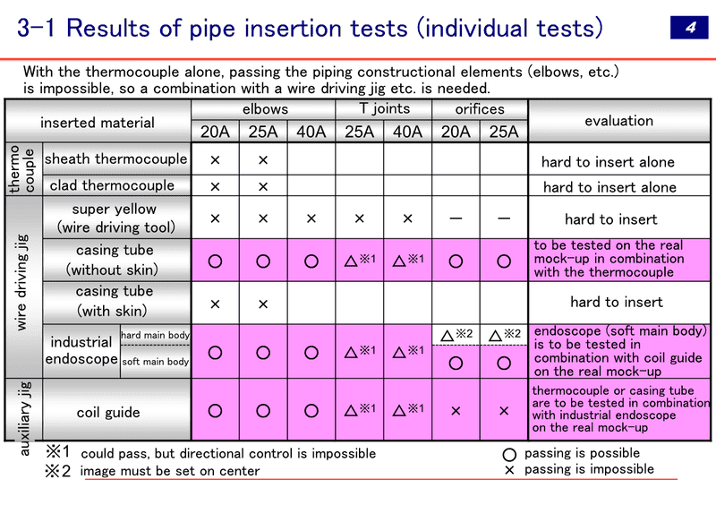

Translation:
4/12
5/12
6/12
Thermometer mockup 04of12.png   Thermometer mockup 06of12.png   Thermometer mockup 05of12.png

Translation:
7/12
8/12
9/12
Thermometer mockup 07of12.png   Thermometer mockup 08of12.jpg   Thermometer mockup 09of12.png

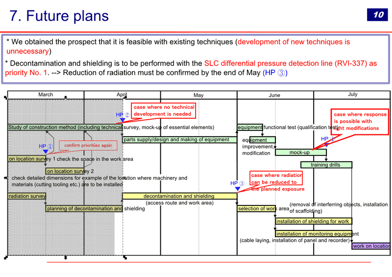

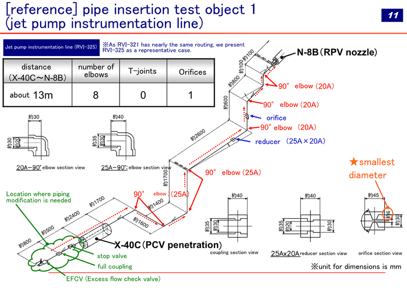

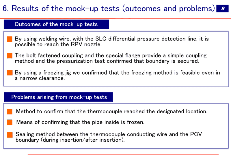

Translation:
10/12
11/12
12/12
Thermometer mockup 10of12.png   Thermometer mockup 12of12.png   Thermometer mockup 11of12.png

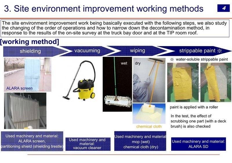

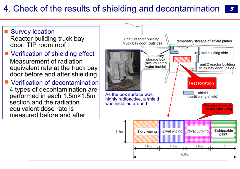

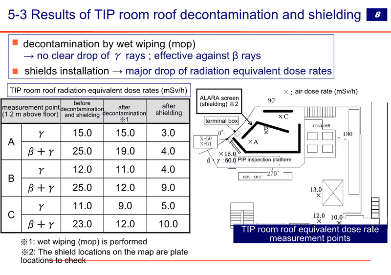

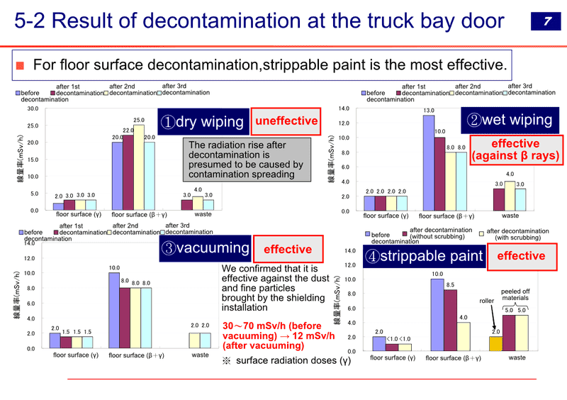

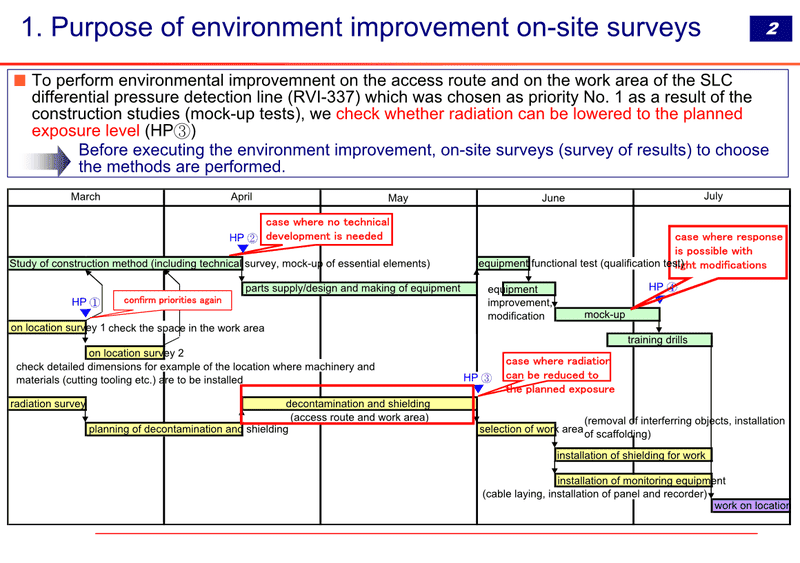

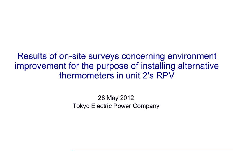

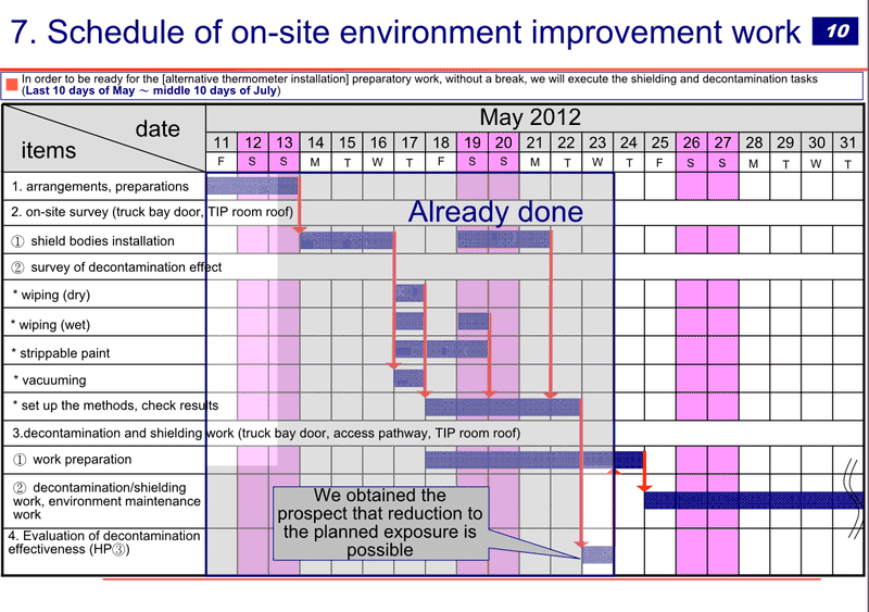

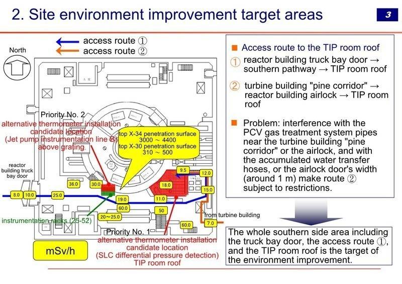

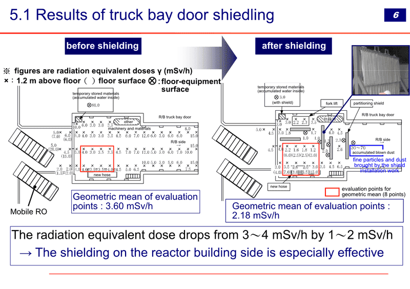

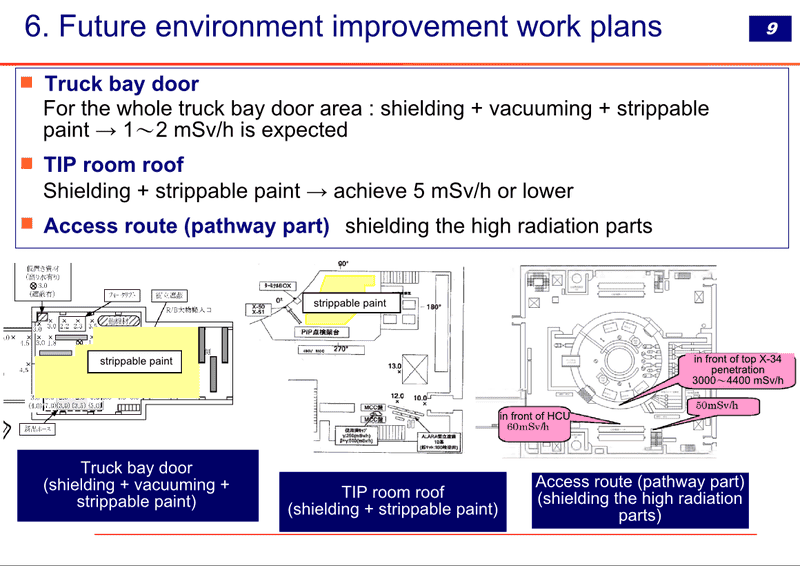

The 6th mid long term meeting was held yesterday: http://www.meti.go.jp/earthquake/nuc...120528_02.html
28 May 2012 government-Tokyo Electric mid and long term response committee, steering committee (6th meeting)
http://www.meti.go.jp/earthquake/nuc...120528_02h.pdf Results of the surveys on location concerning the environment improvement for the purpose of installing alternative thermometers in unit 2's RPV.
See also on the same topic (alternative thermometer insertion) : my translation of the 1 March 2012 report ( http://www.physicsforums.com/showpos...ostcount=12465 part 1, http://www.physicsforums.com/showpos...ostcount=12485 part 2, http://www.physicsforums.com/showpos...ostcount=12492 part 3) and of the 23 April report just above ( http://www.physicsforums.com/showthr...78#post3939578 )
See also the videos:
http://photo.tepco.co.jp/en/date/201...20601_02e.html "Decontamination around the truck bay door at Unit 2, Fukushima Daiichi NPS" (released on 1 June 2012)
http://photo.tepco.co.jp/en/date/201...20601_01e.html "Mock-up test to check the insertability of the alternative thermometer at Unit 2" (released on 1 June 2012)
Translation:
1/10
2/10
3/10
unit 2 decontamination 01of10.png   unit 2 decontamination 02of10.png   unit 2 decontamination 03of10.jpg

Translation:
4/10
5/10
6/10

Translation:
7/10
8/10
9/10
