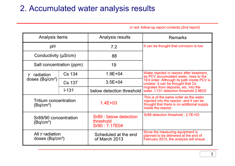

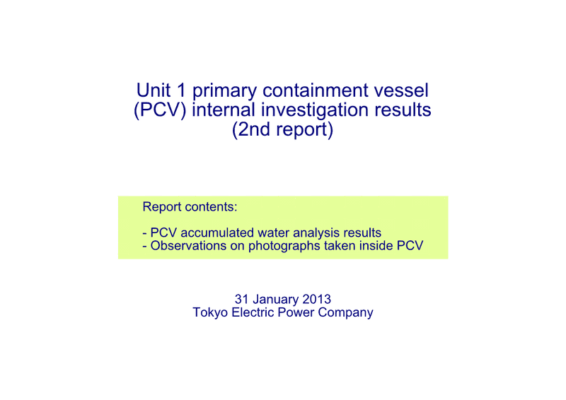

Quote by tsutsuji View Post

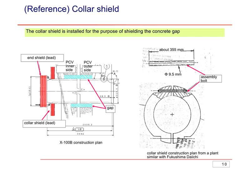

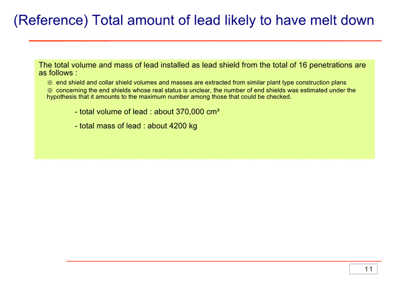

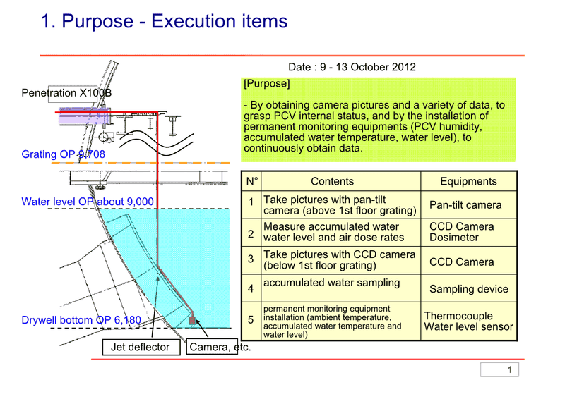

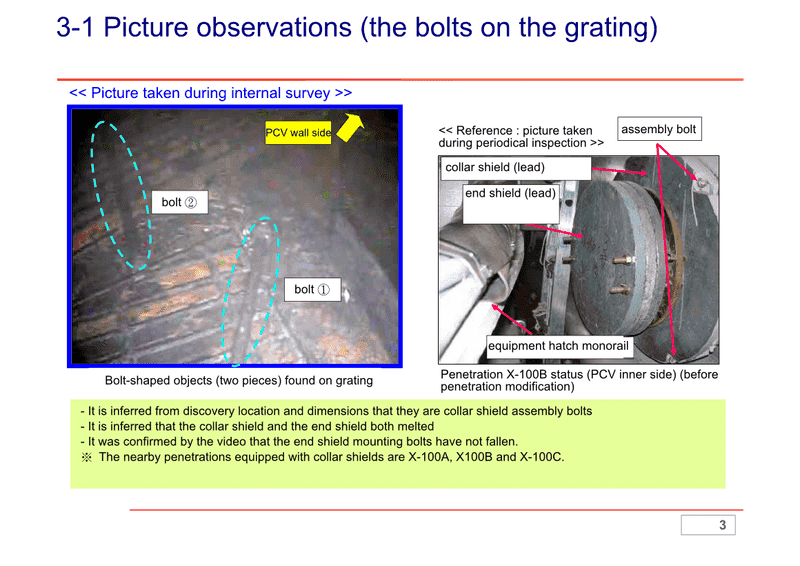

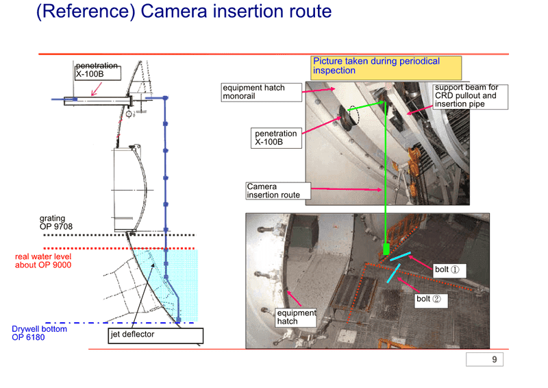

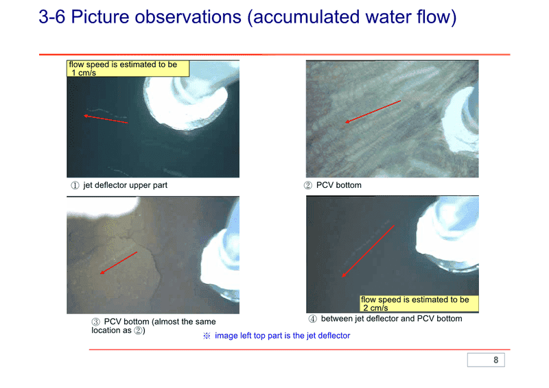

the monthly mid & long term report dated 31 January 2013 (151 pages, 7.3 MB, Japanese) :
http://www.tepco.co.jp/nu/fukushima-...30131_01-j.pdf
3-1 Cooling by closed loop water injection
18/151 - 29/151 : Results of unit 1 PCV internal survey (includes PCV accumulated water analysis and observations on the taken photographs)
Translation :
18/151
19/151
20/151

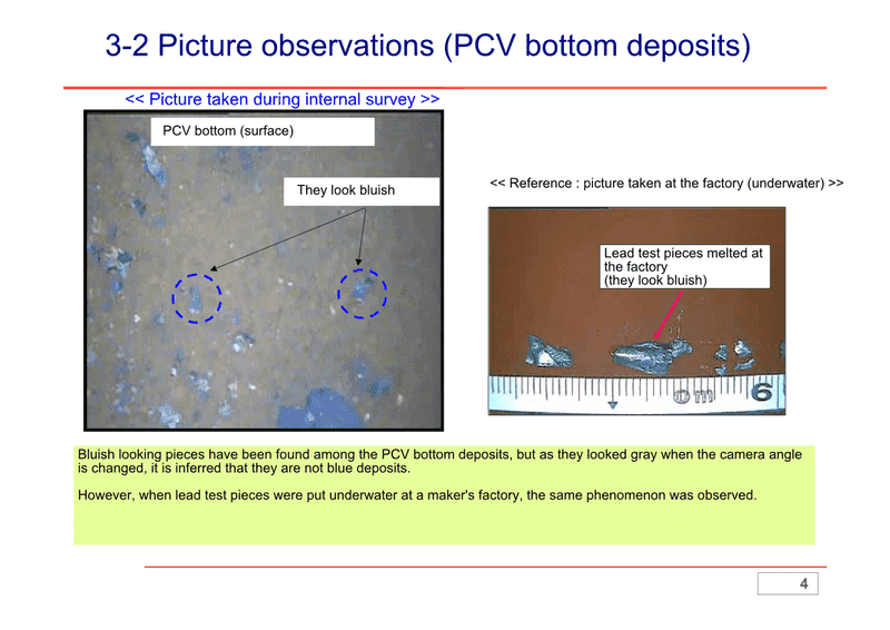

Translation :
21/151
22/151
23/151

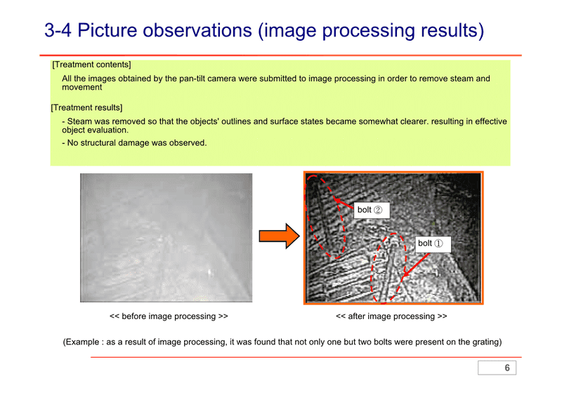

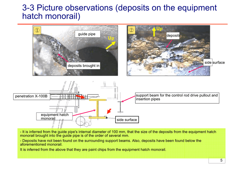

Translation :
24/151
25/151
26/151

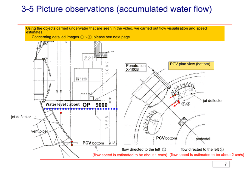

Translation :
27/151
28/151
29/151
