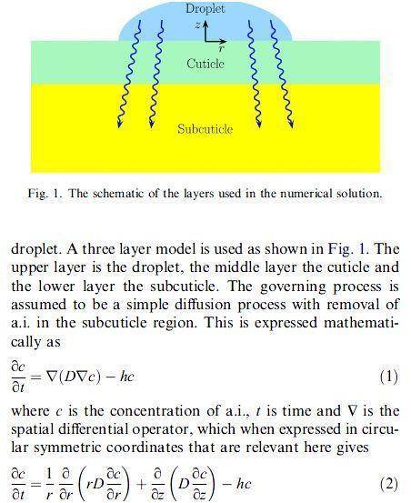

Hey,
I want to solve a parabolic PDE with boundary conditions by using FINITE DIFFERENCE METHOD in fortran. (diffusion) See the attachment for the problem
The problem is that there is a droplet on a leaf and it is diffusing in the leaf
the boundary conditions are
dc/dn= 0 at the upper surface of drop as well as the leaf
and
dc/dz = 0
for the bottom most layer
and the width is taken very large
Can anyone help me please in making the grid for using FDM
the Droplet is not hemispherical in shape.

I told you earlier
a) Make a Mesh via matrix, arrays, selecting regions, and inputting appriopriate zeros e.g. a zeros array
b) Input your initial conditions into that array
c) discretize your equations into finite difference (conditions for the top, bottom, and central part of the body)
d) solve via time-marching, or where you solve for the next time interval from the previous.. since this is a transient problem
e) make sure your answer is reasonable
