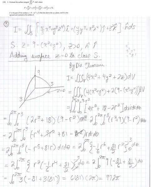

See figure attached for problem statement.
See figure attached for my attempt.
What I decided to do was add a surface z=0 so that S became a closed surface.
Then I preformed the integration using divergence theorem and obtained a value of 972pi
Now all I have to do is remove the portion that the surface z=0 contributes.
How do I figure this out? I'm looking at the given F and I can see that the normal for z=0 will simply be, [tex]\hat{k}[/tex] and that will be dotted with the z component of F which is,
[tex]z^{2}[/tex] but z=0 so it's going to be 0.
Is what have done the right approach?
Thanks again!

As for your solution. First, your surface isn't just in the first quadrant. Second, when you set up your triple integral, you don't plug the z on the surface in the integrand. The inner integral will have limits z going from z =0 to z on the surface.

I only drew the surface in the first quadrant to get an idea of what it looked like, I knew it was in all quadrants but perhaps I should do a full drawing next time.

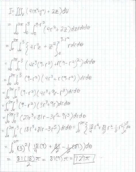

Alrighty here's my second crack at it. (See figure attached)
Any problems?

Your setup is OK. I didn't check all your steps but at most there would only be algebra errors, if any. Looks like you're good to go...

Also do I have to think about removing the portion that the surface z=0 contributes?
I think if you were to calculate that it would be 0 anyways.
We know that the unit normal to this surface will simply be [tex]\hat{k}[/tex] dotting this with the k-component of F when z=0 will simply provide us with the integral of 0.
Is this correct?
Is this correct?
Yes. I didn't comment about that part because you were thinking correctly. If it wasn't zero you would have to account for it.
