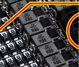

one more thing, i suck at identifying electronic compoenets. Who makes this inductor? supposedly can deliver 50a of current:

A 24 phase VRm, is a 24 phase voltage regulator module. On a motherboard, it consists of the following:
A pulse width modulator, basically outputs a PWM frequency to drivers, the drivers control high side and low side MOSFETs(one pair) and then output into one inductor and then capacitors.
Each phase of the 24 phase power supply has all of the above, but its a bit different.
First we have DriverMOSFETs(DrMOS) which consists of a pair of MOSFETs and Driver all in one IC, so we have the PWM sending a PWm signal to the DrMOS, which then send a driver signal to the integrated high side and low side FETs, and then output to an inductor and then a group of capacitors. There are 24 inductors, 24 Driver MOSFETs, 1 PWM and a bunch of input and output capacitors which all make up the power supply(VRM).
The problem is that the PWM is only a 6 phase PWM, meaning it only has 6 channels and is meant to be used with only 6 sets of DrMOS and inductors, so the company that makes the PWm patented a phase doubler scheme, so there are 18 other phase doubling ICs, i wanted to know how they work. The patent i linked has been put into use already and the manufacturer has a white sheet that resembles schematics in a patent application.

The power supply pictured , the 24 phase vrm, gives a variable output voltage, but every phase outputs the same voltage and current. Another output voltage requires another buck converter, and the motherboards have many, one for the uncore parts of the processor, one for the RAM, one for the IOH, and other things like sata controllers use LDOs.
basically that power supply takes 12v from the computers main power supply and changes it into min 0.9-max 2.1v(no one goes that far).
each DrMOS can only output 35 amps at 0.9-2.1v.
each DrMOS outputs to its inductor, and all the inductors output to the same PCB power plane.
