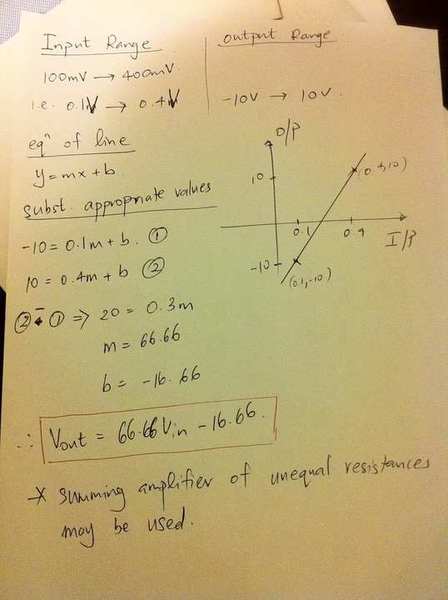

For example like this
Input range 100mV to 400mV and output Range is -10V to 10V. And it says design a zero-span ckt,
edit:changed input range from 40mV(mistake) to 400mV
I haven't heard the trem "zero-span" before, but it probably means two different adjustments.
They want 100 mV (DC) to produce -10 volts out and 40 mV (DC) to produce +10 Volts out.
So, the input signal varies by -60 mV and the output signal varies by +20 Volts so you can work out the gain (and whether the output is inverted).
Also, a DC offset would be involved.

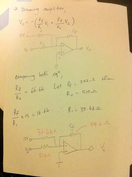

ok. I am to design a ckt. where the inputs range from 100mV to 400mV and the output ranges from -10V to 10V. I have attached my workings and a final design of the op amp ckt. Am I on the right track?
The input voltages were 100 mV and 40 mV.
I think you are using 400 mV.
I got a gain of 333.

Sorry that should be 400mV. I have edited the post above.
100 mV gives -10 V out
400 mV gives +10 V out
So, should you be using an inverting amplifier?
