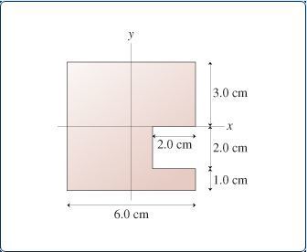

What is the x and y coordinates of the center of mass for the uniform steel plate shown in the figure ?
x=1/M [tex]\sum[/tex] x dm
I am not really sure how to being this one. Mass isn't given so I am not sure where to start. I feel like this will be really easy to do but I am just not sure how to begin it. I appreciate any help. Thanks!

You won't need the mass, it will cancel out.
You didn't attach a figure.
Please show an attempt at a solution using your knowledge of your relevant equation. Look at each axis separately, and choose convenient ones as reference axes.
Here are two helpful tips:
1. The center of mass equation is linear. This means that once you find the center of mass of an object, you can treat the object as a point mass located at its center of mass.
2. For this question, it's easier to consider the object as a square combined with another square of negative mass.
