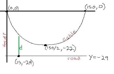

Darn, I just made a graph to help visualize!
Halls of Ivy did a good job explaining it, but now I have this graphic that would otherwise go to waste. They want distance d. (Note: the graph is shifted differently than Halls' but the process is the same.)
Excellent graph! Yes, you can set up your coordinate system however you choose and QuarkCharmer chose to take the origin at one of the cable ends. Of course, the answer to the question will be exactly the same.
