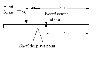

A 3m board is carried and has a weight of 32N. 1.8m sticks out behind the carriers shoulder,1.2m in front and his hand is 0.4m from the shoulder.How much downward force needs to be applied at the hand to stabilise the board. Assume the weight is evenly distributed along the board. I'm confused.

Call the reaction forces A and B.
Write out the vertical components equation, and then the moments equation about the shoulder as the pivot point.
Nope I'm lost. But thanks for your help.I feel like its in there but the more i try to make sense of it the more my brain feels like exploding. 32N pushes down on his shoulder and 32N back up - pivot point must be 0.3m from his shoulder and 0.7m from his hand ? I don't get vertical components and moment equation ? I'm studying by distance and our lecture really skimmed through this bit, i should take it up with the lecturer but think I've left it too late. I love trying to work it out but I just can't make sense of the method...arggghhhh
Perhaps a diagram would help.

That's right … so the vertical components equation is A + B = 32 :smile:
Yes and no :smile:
You can choose the pivot point to be anywhere.
You've chosen it to be where the weight W is.
So you'll have a moments equation involving A and B but not W.
That's fine … that'll be your second equation in A and B, and you can solve the two equations simultaneously.
Perhaps an easier way would be to use the shoulder as the pivot point … then your moments equation involves A and W but not B, which is quicker to solve. :wink:
Do it both ways, just to see …
what do you get? :smile:
