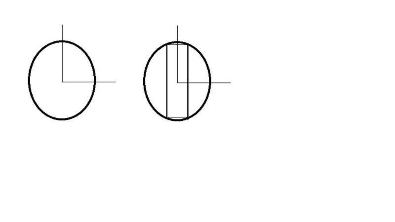

Basically my question is:
I have a circle an every point in the circle as (x,y). I need a transformation that changes every point in the circle to a point in a rectangle (x',y') so I could write x' in terms of x and y' in terms of y.
If you look in the attachement you can see what I mean :)
ps. I am not that concern about the base of the rectangle it could be circular so that y=y' but I am stuck with the x'
Thank you!!

If your mapping needs to be conformal, as indicated by your post title, then my previous post should give you the words you need to search for either in Google or a complex analysis book; this should point you in the right direction so that you can figure out your mapping. By the way, the Mobius transformation is the same as the "linear fractional" transformation, which may help in your search.
May11-11, 06:30 AM   #8
Hi JasonRF,
It certainly needs to be conformal... Thank you for your great answer I will look into this direction, and sorry I posted my reply with the attached figure before reading yours.
