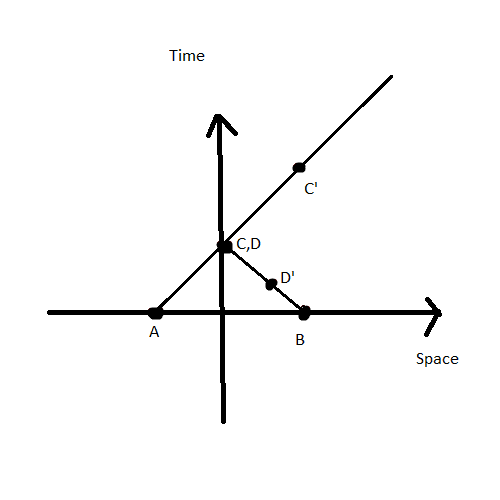

I tried making a spacetime diagram, I've uploaded the image. This is in the frame of reference of the SO, events A and B are the lightning strikes, C and D are receiving of left and right strikes respectively by the SO and C' and D' the same for the TO. It didn't help me get any further insight.

In these diagrams the observer in the middle of the train thinks the light beams were emitted simultaneously ( grey worldline) from the back and front of the train but in the maroon frame the beams are clearly not emitted simultaneously.
The diagrams are accurate ( barring user clumsiness) and are related by a Lorentz transformation. Time is on the vertical axis per convention.

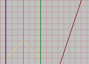

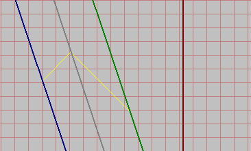

There are two diagrams, which show how clocks are synchronized using the Einstein midpoint method, one for a stationary observer and one for a moving observer.
We have three worldlines in the diagram - the left observer, the midpoint observer, and the stationary observer. All three wordlines are the same, they are worldlines in a stationary frame.
At some event O, the midpoint observer emits a pulse of light. It's received at events a and b. In the stationary frame, a and b are then regarded as happening "at the same time"
In the second diagram, we having the case for a moving fame. Again, we have the worldlines of three observers, a left observer, a midpoint observer, and a right observer. Again, the midpoint observer emits a pulse of light at time O. It's received by the left and right observers at events a' and b', which are regarded by the moving observer as simultaneous.
Inspection of the picture, though, will show that while a-b is a horizontal line, the line a'b' is not horizontal, but slopes. This demonstrates that notions of simultaneity are different for moving and stationary observers.
If you put one diagram on top of the other, super-imposing them, you can do this so that event a and event a' are close ("at the same time and at the same place"). Because event b is on a horizontal line, and event b' is on a sloped, if events a and a' are made to occur at the same space-time coordinates, events b and b' can NOT be made to occur at the same space-time coordinates.
In other words, the set of events simultaneous to a, in the stationary frame, is a different set of events than the set of events simultaneous to a', in the moving frame.
I hope this helps.
