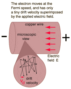

I'm not to fond of animations but here's a Wikipedia one for three phase "power flow".
[URL]http://upload.wikimedia.org/wikipedia/commons/4/48/3-phase_flow.gif[/URL]
One misleading thing about that animation is that the electrons move at a few mm/second maximum and they end up moving a microscopic distance each cycle.
Also, it's Current flow that they are showing - not Power flow. The Power goes steadily from generator to load, not back and forth; there's no generator in your house!
EVERY illustration and animation is going to have something drawn out of scale so that it's easier to see. Most of the illustrations used to begin an ADC/DAC topic show only 2-3 bit conversion, despite the fact that most ADC/DACs are at least 8 bit. For conceptual understanding, 2 bit is much easier to see than 8 bit.
For a lot of difficult to understand things, drawing them exactly to scale would be useless.
You are right except that people tend to think that the electrons go racing up and down the supply cables from generator to load and back. A caveat is needed, I think.
And how about my comment about Current and not Power? You can't disagree with that, can you?
Exactly. Thanks for this very important fact.
Not an animation but...
Read more about this here:
http://hyperphysics.phy-astr.gsu.edu/hbase/electric/ohmmic.html"
and here:
http://hyperphysics.phy-astr.gsu.edu/hbase/electric/miccur.html"
Drift velocity is a rather unimportant value for most electronics work, isn't it? Though I do agree that the exaggerations should be mentioned along with the illustration.

In DC, there is a steady, very slow, drift of electrons in one direction. In AC, there is no net movement of electrons - just bacwards and forwards. BUT the electrons are also moving about at a range of speeds and in all directions - much more than the drift speeds due to the 'electrical current'.
The only 'wave' associated with 50Hz AC has a wavelength of 3e6/50m. Very big, you'll agree, and much larger than any circuit you are likely to build at home.
As the electrons move forward in the wire you have a positive charge, and they move backwards you have a negative charge. The current is alternating back and forth.
If you were to graph that as a function of time you would end up with an oscillating sine wave. Up-down related to forward-back.
That's probably an oversimplification, but it's how I understand it.
You may have to re-think that bit about a charge. There are always the same number of electrons in a wire - as one enters one end, another leaves at the other end. (That is when the frequency of the signal is low, like the mains, or DC.)
The "up-down" you refer to is just for the purposes of the current / time graph - not reality.

Think of a mechanical hand crank. Your hand may go backwards and forwards, not 'getting anywhere' but you still input work into the system you are Powering.
It's the Power that is transferred in AC circuits - not the Current.
