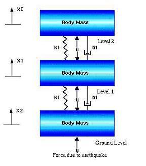

The problem is a 2-spring-damper system with three levels. A ground level, level 1 and level 2. Then a force is applied to the ground level simulating an Earth quake (eg the force could be sinusoidal). See the attachment for a diagram.
These are the forces I have resolved:
-level 2 mass:
gravitational force, m0*g (down)
Spring Force2, K1*(x1-x0) (up)
Damper Force2, b1*(x1'-x2') (up)
Inertial Force, m*x0'' (down)
-level 1 mass:
gravitational force, m*g (down)
Spring Force1, K1*(x2-x1) (up)
Damper Force1, b1*(x2'-x1')(up)
Inertial Force, m*x1'' (down)
Spring Force2, K1*(x1-x0) (down)
Damper Force2, b1*(x1'-x2') (down)
-level ground mass:
driving force (earthquake) = some function eg sine
g-force, mg (down)
Spring Force1, K1*(x2-x1) (down)
Damper Force1, b1*(x2'-x1')(down)
Inertial Force = m*x2'' (down)
I have tried to solve this using simulink, but for the positions of each level they fall towards negative oblivion. I am thinking I either have forgotten some force added too many.
Have I left anything out? *thinking*
James

Hi, this looks a bit like active suspension control...
i get following equations :
m0x0" = -k1(x0-x1)-b1(x0'-x1') + U
m1x1" = k1(x0-x1) + b1(x0'-x1') - U - k1(x1-x2) - b1(x1'-x2')
m2x2" = k1(x1-x2) + b1(x1'-x2') - U
Ofcourse you need to add the overall gravitational force which you implemented correctly in my opinion.
x : position
x' : velocity
x" : acceleration
just for clarity...
regards
marlon
m0 is level two
m1 is level 1
m2 is groundlevel
Just to make sure, ok ?
regards
marlon
Thanks Marlon for the reply. What about when I add a driving force on ground level?
This is assuming that the springs are fully relaxed? I have calculted the displacements due to the weight of each level. What should be done to may this system dynamic?
Thanks
James
edit: oops for some reason I thought U=mg. U= driving force! But still does this consider the initial displacement of the springs?
