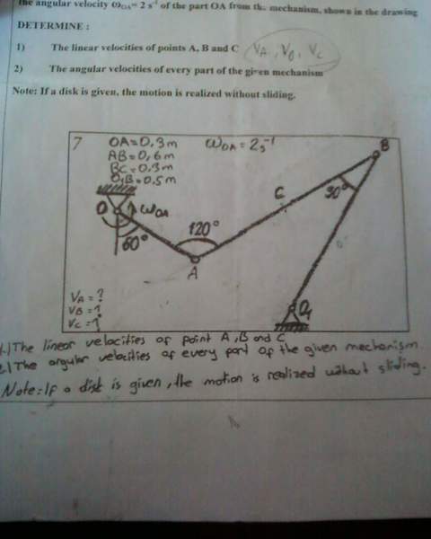

For the given positions
OA=0,3m ;
AB=0,6m ;
BC=0,3m ;
O1B=0,5m ;
ωOA=2 s-1 of the part OA from the mechanism , shown in the drawing.
DETERMINE :
1-) The linear veocities of points A , B and C
2-) The angular velocites of every part of the given mechanism
Note= If a disk is given , the motion is realized without sliding.
Here is the link for figure.
http://www.yukleresim.com/viewer.php?file=43049722008396930993.jpg"

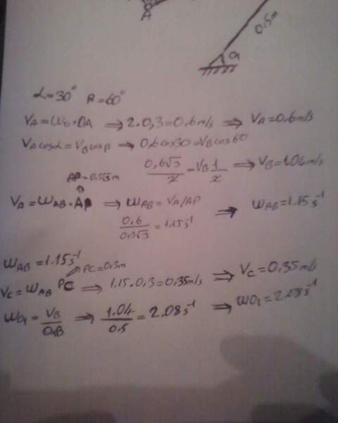

Va = 0,6m/s ...but i am not sure others..Please help me for others..Because Va is easy..But others are hard for me because i am high school :(
Thanks for Help ..Here is the my answers..But how can i find Vc...and angular velocities..

Your link isn't working anymore, I get "404 Not Found - The page or file you requested does not exist."
But your angle alpha is correct. I'm having a memory lapse with respect to beta-- I really need to see the exercise again.
If both angles are indeed 30 degrees than they are indeed equal (Va = Vb)...as far as Vc, well I'd like to see the diagram again.

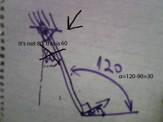

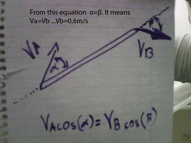

aha i am sory about this...Here you are...yes alpha and Beta i think are equal...and then Vc is equal too ...Now i need one more help for angulae velocities ...thanks again :)
Actually you need the beta of the third drawing. Oops. My bad, I defined beta differently in the last image. That's the beta you need. You'll find out that's 60.
So it's really should be
Vacos(30) = Vbcos(60)
Which means they aren't equal.

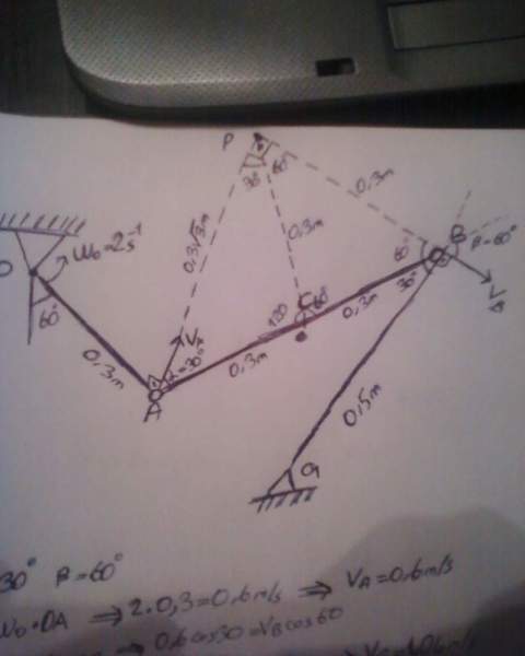

As far as Vc, it's definitely not equal to the rest of them, but we'll get to that later. First you need to find P, the instanteneous axis of rotation,
I'd advise you to look at this image as an example problem to see how they locate P:
[PLAIN]http://img3.imageshack.us/img3/8868/solman222.jpg
Its location should be quite obvious, it's where the two tails of Va and Vb meet. You can use this formula:
Va = omega x radius
To find omega of that particular shaft.
Notice that the radius is the distance from Va to the instantaneous axis of rotation
Thanks for the hint :)...Here is the my answer can you please check it ..First picture is for the point P..I draw The all necessary points and shafts. Second picture is for the solving way...I am really glad to meet you :) ( sory for my language its not my main )

Are you telling me that the distance from Vc to P and the distance from Vb to P are equal?
Look at the trigonometry, see if it makes sense. To make think simpler, here is how you find the angular velocity of AB (I'm not familiar with the formula you used)
http://img691.imageshack.us/img691/2336/thisformula.jpg
You know Va, you know its angle to AB, you know Vb, you know its angle to AB, and you know the length. You can solve for omega
