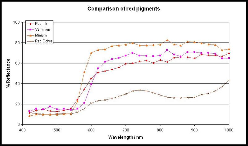

There are infinite number of ways to create what you would call a "yellow" light.
Same goes for "red" pigment.
The problem you have referred to may actually have two solutions:
1) "yellow" light with wide spectral distribution (incandescent lamp) shining onto a red pigment that only reflects narrow red -> pigment looks RED
2) "yellow" light with narrow spectral distribution (LED) shining onto a red pigment with wide reflection spectrum -> pigment looks YELLOW
Drakkith said:
Typically we say that something that is X color absorbs ALL other colors except for X color. I assume that they mean the paper is a pigment that reflects ONLY red light.
Surprise, surprise! Take a spectrodensitometer and try scanning stuff around. You will be amazed.
I have one of these: http://www.xrite.com/product_overview.aspx?ID=278 so I can scan something if you wish me to.
Even the most "deep" colours reflect an awful amount of other light.
Monochromatic "yellow" light has wavelength about 590 nm.
