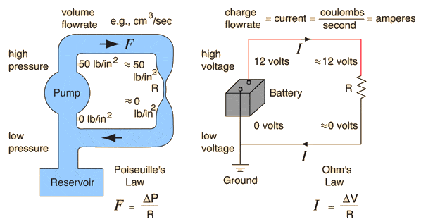

I not the biggest fan of using http://hyperphysics.phy-astr.gsu.edu/hbase/electric/watcir.html" , but see if this helps. From the link:
Looking at 1300 AH, you can't say that the battery delivers 1300 Amperes of current to anything connected it with. Actually, it has nothing to do with how much current flows. So first lift that off your mind.
The answer to how much current flows is given by its terminal voltage, i.e. say 12V.
That alone also, don't tell how much current flows.
To know, how much current flows, you need to know the type of load.
As a demonstration of how this works, I would say
If you connect a 24 watts bulb, 2A current will flow
If you connect 12 Watts bubl 1A current will flow
If you connect a 2 ohm heater, 6 ampere current will flow
So, as you see, how much current flows is based on the battery voltage rating and the rating of the Load.
Now How long will the bulb glow? How long will the battery last.
This question is answered by the AH rating of the battery. In our case, the battery is 1300 AH. Which means, if we connected a ** load of ** rating, so that 1300 Amperes of current would flow, then the battery lasts for 1 hours.
In our case of say 12 watts bulb, we calculated current to be 1 Amperes, way less than 1300 Amperes. So, our battery should last for 1300 / 1 = 1300 hours.
Ask more, if you like.
