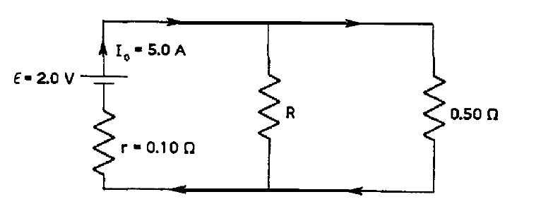

What is the value of resistance R in the figure, if the current through the battery is 5.0A?
V=IR
Rt = (1/R1 + 1/R2)^-1 + R3
Rt = V/I
Rt = 2V/5A
Rt = 0.4ohms
0.4 = (1/0.5 + 1/R)^-1 + 0.1
R = -5 ohms
(the answer given is 0.750 ohms)
Everything looks correct down to and including 0.4 = (1/0.5 + 1/R)^-1 + 0.1
I started from that point and got the correct answer. Check your arithmetic again.

oh yeah haha you're right, I messed up in my algebra, thanks!
