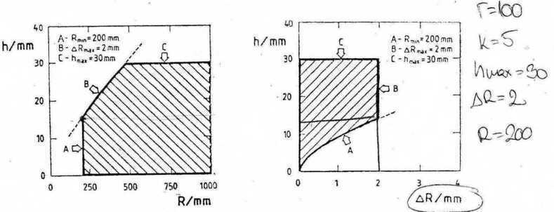

bear_25
Hello, i am new in using MATLAB, and i stuck with these two graphs (attached). Can anyone help me, please. Thank you.
Welcome to Physics Forums.
What exactly are you stuck with? Are you trying to plot them?
Thanks.
no, i am confused how to write this in Command Window in MATLAB, because for now i just start to use MATLAB.
bear_25 said:
Thanks.
I'm afraid that I still don't understand. What exactly are you trying to do?
well, i need to plot this two graph in MATLAB, but i don t know how.
So you do want to plot these, like I said earlier.
I'm not aware of any in-built function to plot shaded regions (you could plot the boundaries quite easily). However, the plotregion function from the File Exchange would likely do what you need: http://www.mathworks.com/matlabcentral/fileexchange/9261-plot-2d3d-region
Can you tell me how can i plot the boundaries? I really need help.
I can't give you a full tutorial on MATLAB plotting. Instead, have a look at this: http://www.mathworks.co.uk/help/techdoc/ref/plot.html , try somethings and come back with specific questions.
Well, i have done this graph in MATLAB:
rA = 25;
kA = 2;
hAmax = 7;
rB = 40;
kB = 4;
hBmax = 27;
rC = 60;
kC = 5;
hCmax = 55;
R = 200;
i = 0;
for dR = 0:0.001:4
i = i + 1;
hA(1,i) = rA*(1 - cos(asin((sqrt(2*R*dR + dR.^2) + rA*sin(acos((rA - kA)/rA)))/rA))) - kA;
hB(1,i) = rB*(1 - cos(asin((sqrt(2*R*dR + dR.^2) + rB*sin(acos((rB - kB)/rB)))/rB))) - kB;
hC(1,i) = rC*(1 - cos(asin((sqrt(2*R*dR + dR.^2) + rC*sin(acos((rC - kC)/rC)))/rC))) - kC;
end
hA(hA<0) = 0;
hA(abs(hA)>hAmax) = hAmax;
hB(hB<0) = 0;
hB(abs(hB)>hBmax) = hBmax;
hC(hC<0) = 0;
hC(abs(hC)>hCmax) = hCmax;
figure
plot(0:0.001:4,hA,'r')
hold on
plot(0:0.001:4,hB,'b')
plot(0:0.001:4,hC,'k')
xlabel('Bočna deformacija, dR/mm')
ylabel('Visina krojne naslage, h/mm')
grid on
Now i need to get those two graphs but i don t know how to set boundaries inside the graphs which are attached
