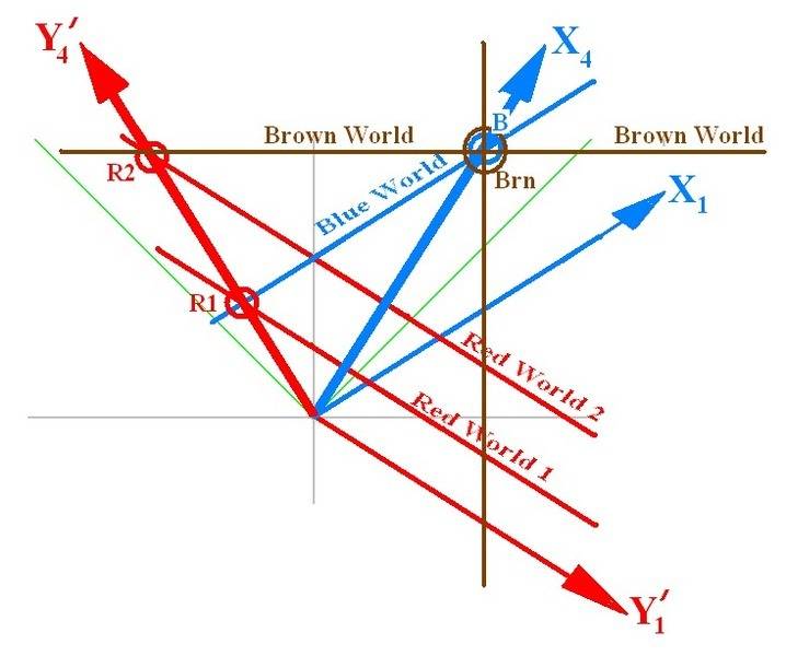

A blue guy and a red guy are moving at the same speed in opposite directions with respect to some rest system as depicted in the sketch below. Both guys are moving into their respective 4th dimensions at light speed. The same proper time has lapsed for blue and red at their respective events labled "B" (for blue) and "R2" (for red). But, when Blue is at his "B" event, his 3-dimensional "Blue World" includes Red at red's "R1" event.
Question: Which 3-D world (Red World1 or Red World 2) is the Red guy physically really living in at the time blue is living in his "Blue World" containing event "B"?
Hmm, we have such precisely defined physical concepts as the 3-d world someone is "really living in". I don't know about you, but I experience what my senses tell me at one location at a given moment. All else is interpreted relative to a (hopefully useful but not directly verifiable) model.
By typical simulaneity definition, red at R2 considers B in his future. However, by the notion of "conventionality of simultaneity", red at R2 may consider any event with spacelike interval as simultaneous with R2. The red at R2 can pick any event from Blue a bit before your "red world 2" crosses the blue world line until well after B as simultaneous.
Another phrasing of this idea, is: any part of B's worldline which can neither be influenced by R2 nor influence R2, is causally disconnected such that not only statements about simultaneity but even existence are unknowable hypotetheses.
Just another obvious comment: per standard simultaneity convention, B says R2 is in its future, R2 says B is in its future, and this is a perfectly normal statement in the context of relativity of simultaneity.
Thanks for the excellent comments, PAllen.
I'm going to try to make the question a little more specific. A third observer is thrown into the mix--the Brown guy. His event, "Brn", coincides with the blue event, "B". They both have the Red guy in their respective 3-D worlds at that instant in time.
So now, which 3-D world is Red living in at the time of the shared event "B" and "Brn", Red World 1 or Red World 2?

It doesn't change anything. If R takes the minimalist perspective, they say anything outside their light cones at R2 is unknowable, unknown simultaneity (for all R knows at R2, Blue and brown are anti-particles, and changed direction to annihilate before the B/Brn event (on their world lines). If R takes the conventional Lorentz simultaneity convention, R2 is the simultaneity surface. B is in R2's future, and the presence of Brn at the same event has no relevance. So, with the Lorentz convention, Brn says R2 and B/Brn are simultaneous, B says R2 is in the future of B/Brn, R2 says B/Brn is in its future. Again, this is all normal.
Within the limitation that a simultaneity convention relates spacelike events, there are many other possible conventions, some producing 'nicer' results for comparing a hypothetical rocket log with Earth log after a rocket returns to Earth (i.e. they are smoother in the presence of sharp accelerations). However, if these are used to build coordinates, the things like Maxwell's equations take a more complex form even in the inertial portions of a rocket round trip.

I agree with what PAllen and pervect have said. I'll just pick up on one point:
The phrase "...at the time..." only makes sense if you have already decided on what "simultaneity" means, so it's just as coordinate-dependent as everything else already mentioned.

Good point, DrGreg. And thanks for the pointers on the graphics. I was not happy with taking up all of that screen space. That's the problem with using Paint *.bmp files. I'll have to get familiar with PNG.
I appreciate the points about the coordinate dependency of simultaneity and the future and past events. And, again, I certainly agree with all of the points raised in the above posts.
After reflecting on the above responses it leaves me wondering if, in the view of most physicists (and I regard you folks as doing a pretty good job of representing views of physicists), special relativity does not allow us to make a statement (referring to my example) about what 3-D world Red is living in when Blue and Brown share the event "B" and "Brn". Perhaps you feel physics cannot say what 3-D world Red is "really" living in (and here I'm referring to Red's 3-D World 1 and/or World 2--not just the event R1 or R2).
This is all very philosphic, but I would say it is reasonable for an inertial observer in sufficiently flat spacetime to think in terms of Lorentz simultaneity:
If they are following the red world line, then at R2 they 'live' you red world 2. The red world they live in that includes the B/Brn event is one well in the future of R2.

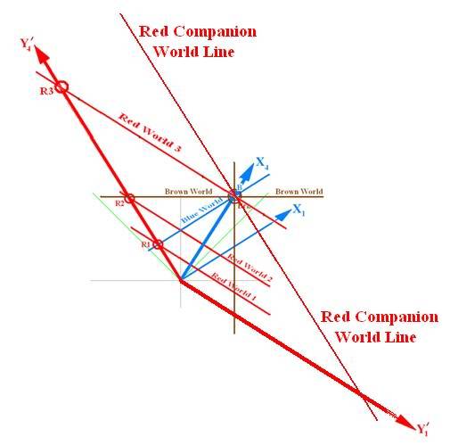

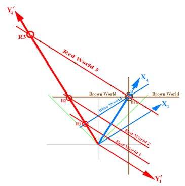

Thanks for pointing out one more 3-D world (Red World 3 in the diagram below) that should be included for consideration. So, we have the blue guy seeing Red at "R1" at the same time the Brown guy sees Red at "R2", while Red sees Blue and Brown at "B"/"Brn" when Red is at "R3". (please avoid complications of accounting for delays associated with light transmission--we are concerned with the inertial frames).
Can we say anything about the 3-D world Red occupies in this scenario?
We can add in a companion to the Red observer. We add in the Red companion's world line; it shares the event that is also shared by the Blue and Brown guys at "B"/"Brn".
So, now we can imagine a brief exchange of comments between the three guys as they pass each other at the "B"/"Brn"/BlueCompanion event. Blue says, "Hey, I have the Red guy in my 3-D World at event R1." Brown says, "No way. I have him in my 3-D World at event R2." The Red guy's companion (who has been stationed at some distance along Red's X1 axis) says, "You guys are nuts. My Red boss gave me instructions to wait out here until I meet up with you guys to let you know that I have my Red boss in my 3-D Red World 3, and he is at event R3 even as we speak--even though you guys won't even see event R3 until some time into your future (as suggested by PAllen).
But wait--which one of these three guys is correct? How can Red be in all three places at the same time as Blue, Brown and Red Companion meet?

You are mixing several types of things here. The only one similar to you diagram is speculating on what is happening 'now' on a satellite on the other side of the moon. Most of the others are cases of talking about past events that are causally connected to us (including the big bang - which is in the causal past of the whole universe). I would say it is rather bold to talk about the current status of something a billion light years away, where the last information we have of it is a billion years old. As for black holes, we observe a number of objects believed to be well approximated by the GR model of black holes. I believe most physicists do not believe these objects are exactly described by GR black holes.
As for the satellite, while there may significant signal delays, relativistic corrections to clock rates and simultaneity are so small it would take a high precision experiment looking for them to see a small effect. So one can get away with an image of 'distant now'.

I would say it is reasonable to say that at R3, red world line observer is 'really occupying' red world 3.

They're all correct by useful convention. By the minimalist philosophy I alluded to in earlier posts, they instead say we know nothing about distant now. Instead, at B/Brn/Rcompanion event, they look what time they see on Red's clock - and they all agree (a bit before R1). All else is convention.
Now the standard convention is very useful for inertial observers in flat spacetime because all reasonable ways of measuring simultaneity agree on it. In particular, at the B/Brn event, if all 3 do as follows:
Given the history of what each has seen from red, including speed determined from doppler, distance measured in the past by any reasonable method (radar ranging, parallax, etc.), each computes what time should be on red's clock 'now' (the B/Brn event), each of the 3 will insist on a different answer. How could you possibly say one is right? Each is right for their state of motion, under a reasonable model.
I certainly agree with that statement, at R3, Red is 'really occupying' Red World 3.
However, at R2, Red is 'really occupying' Red World 2. And at R1, Red is 'really occupying' Red World 1.
So, as Blue, Brown and RedCompanion compare notes, how do they resolve the question of which of the worlds Red is actually living in at the time they are meeting (although such a brief meeting!): Red World 1, Red World 2, or Red World 3?
