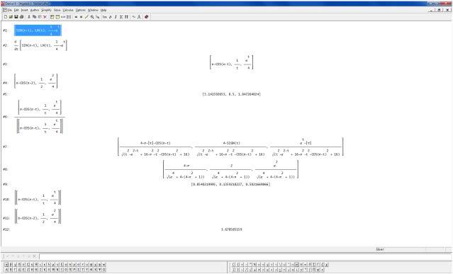

I am still stumped on part (d), I am using Derive 6 to derive,simplify the problems. This is the work I have so far. Double checked all my work and looked online for examples, but I am not finding anything??
Is there a simple formula?? Do I just need to use limits or integration ??

Where are you stuck?
[tex]F(t) =||r(t)||^2 =\sin^2 \pi t+ \ln^2(t) +\frac 1 {16} e^{2t},\ <br /> \frac 1 4 \leq t \leq e[/tex]
Don't you know how to use max/min problems in calculus? The possible values of t are critical points and end points.

Why don't you start by drawing a graph of that? I presume your software will do that. It will show you where your max and min points are. Then look in your Calc I or II book and review where it talks about critical points and finding the relative extrema of functions.
