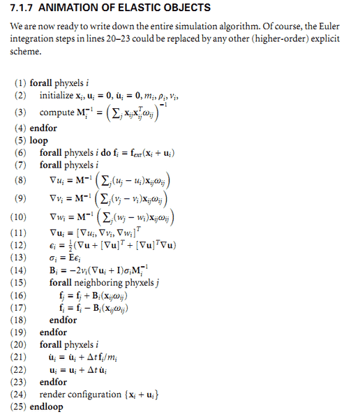

I am using smooth-particle hydrodymamics(SPH) method to model a deformable object. It is based on the procedure found in Markus Gross's point based animation book, the algorithm is attached in the image below.
This algorithm uses Euler for numerical integration as seen in step 21 and 22, and I am trying to see if I can implement Runge Kutta method. However, when I look at the procedure I couldn't see how I can calculate the higher order terms.

The way to do this using RK is:
First find the values of k1 for each the particle in the model.
Them to find k2 for each particle, you assume each particle is at position y + k1 / 2, sum up the forces, and divide by the mass to get the acceleration. You can interpret this "physically" as finding how the forces have changed half way through the Euler step.
Then to find the values of k3 you assume each particle is at position y + k2/2, and so on. That is not so easy to explain "phyiscally", you just have to accept that mathematically it's another correction to the forces to improve the accuracy of the method
And similarly to find all the values of k4.
Finally, you find the position of each particle at the end of the step from the RK formula involving k1, k2, k3, and k4.
Presumably, in this simulation nothing is explicitly dependent on time, so the fact that you calculate k2 k3 and k4 at particular times (k2 and k3 half way through the step and k4 at the end) doesn't make any difference to the calculations. But if you were applying some external forces that varied with time, you would need to use the correct times for each "sub-step" of the RK calculation.
