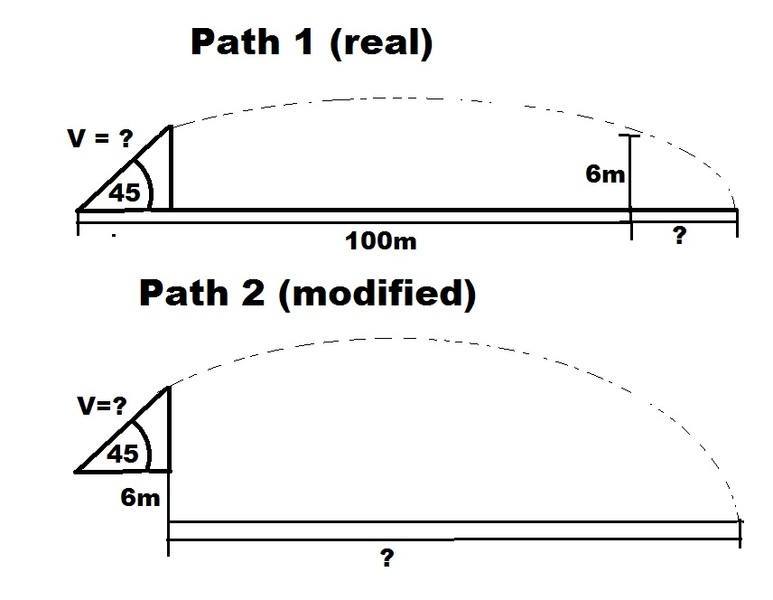

I'm not sure if this is correct, but what if I say that the launch point was 6 metres above ground and I removed the fence. Would the time of flight be that same if the launch was on the ground and the fence was 100m away?
if the velocity of the y component is zero at 100 meters away and Vy=V0 - gt, then what does that tell you about the time it takes to get there?
How would you define the path that the parabola must follow, then, with no obstacle for it to clear? Try a few sketches.
Have you finished solving the problem at hand?
Not yet, but I have drawn a sketch of this two to show my line of thought.
As for finishing the problem at hand... I didn't really understand how it works (it seems like maths is a world apart). I don't know what V0 or Vy means?

If you launch an identical projectile from 6 metres above the ground, with the same firing angle (45 deg) and speed, at 100m it will now clear a fence 12 metres high.
No, my equations are correct.
If you stand on your fence and hit the ground 100 away instead, the bullet would need a different intitial velocity and time of flight. (swap 6m with -6m and work from there).
NascentOxygen said:
If you launch an identical projectile from 6 metres above the ground, with the same firing angle (45 deg), at 100m it will now clear a fence 12 metres high.
Touch'e :approve:
