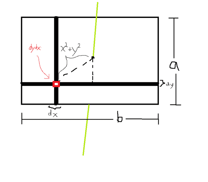

I was trying to find the moment of inertia of a rectangle with width a and height b were axis of rotation is through it's center of mass
I = integral r^2 dm
rho = dm/dA
dm = rho dA
If I take an infinitely small area of an infinitely thin rectangle a distance dr from the point of rotation, it would have a width of dr and a height of b, hence
dA = b dr
dm = rho b dr
I = rho b integral[-a/2,a/2] r^2 dr
I = (rho b)/3 * r^3 |[-a/2,a/2]
I = (rho b)/3 * [ a^3 /8 - (- a^3/8) ]
I = (rho b)/3 * [ a^3/8 + a^3 / 8]
I = (rho b a^3)/12
rho = M/A
A = ab
I = (M b a^3)/(12 a b)
I = (M a^2)/12
I don't see what I'm doing wrong, my book tells me it's I = [ M(a^2 + b^2) ] /12
thanks for any help
I'm assuming that this is asking about an axis of rotation normal to the surface, through the center of mass. In that case, with the differential elements of width da (not dr, since you're dealing with the thickness of thin linear elements instead of the thickness of a ring whose center is along the axis of rotation), the distance r between the axis of rotation and a given point on that thin strip is (a2 + b2)1/2. When you use dr as your differential width, you're essentially setting up a series of infinitesimal rings whose points are all equidistant from the axis of rotation.
Try reevaluating your integral using this information and see if this yields the answer you expected.

Some of them do require multivariable calculus. The good news is that multiple integrals are fairly straightforward. When you have a function such that
F = ∫∫A f(x,y) dx dy
you perform what's called an iterated integral, where you integrate first with respect to y (i.e., you use y as the variable of integration and treat any function of x that is independent of y as a constant) and evaluate it, then integrate the result with respect to x -- or vice versa. You needn't perform those operations yourself at this point, just be aware that that's basically what's being done in a lot of these processes. (I oversimplified the process a bit.)
Anyway, here's basically the MS Paint rundown of why your r2 = x2 + y2:
and so basically what this means is that the differential moment of inertia dI over that differential area element is the square of the distance between the axis of rotation & that little differential area element, times your area mass density. This means that
[itex]I = \int\int_{A} \sigma d(r^{2}) dA = \int^{y = a/2}_{y = -a/2} \int^{x = b/2}_{x = -b/2} \sigma(x^{2} + y^{2}) dx dy[/itex]
That's the basic idea.
Similarly, when you have a three-dimensional mass configuration, your moment of inertia is the volume integral of the product of the mass density, the square of the distance from a differential volume element to the axis of rotation, and the differential volume. It will make more sense after you've had some experience with multivariable calculus, but hopefully this gives you at least a vague sense of the way these things are derived.
NOTE: The limits of integration above assume that you've chosen the coordinate axes such that the rectangle has sides parallel to the x and y axes and the axis of rotation is the z axis.
WJSwanson said:
Anyway, here's basically the MS Paint rundown of why your r2 = a2 + b2:
Impressive artwork. :smile: But doesn't look right. a and b are supposed to be constants, the dimensions of the block. Your diagram should have used x and y, as you used in the algebra in the following paragraph.
Thanks for catching that! lol. Good call.
