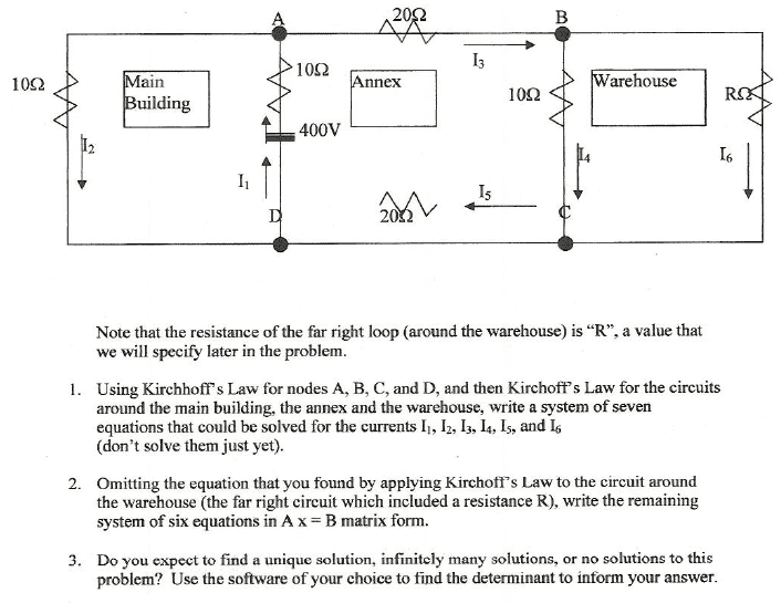

Hello, This is part of a set of questions I need to do for a project
I just need help getting started. I've been looking at this forever and I can't figure it out.
Kirchhoff's Law for Nodes:
Current going into a node = current going out of a node
Kirchhoff's Voltage Law: In one traversal of any closed loop, the sum of voltage rises = the sum of voltage drops.

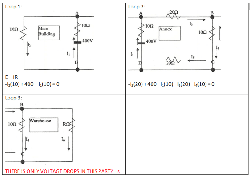

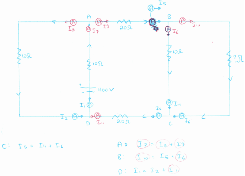

I really have no idea what I'm doing, but I redrew the figure to make it more clear for myself. Please, I need any sort of help. I really don't understand how to get my equations right, I believe after I have my equations down it'll be smooth sailing from there.

You have to pay attention to the directions of the arrows you have drawn.
For the nodes, it usually does not matter which direction you draw the arrows, though it helps to have at least one arrow going in and make sure you follow the currents around since current out of a component = current into a component.
Take a look at what you've drawn for node A.
On your diagram, I8 and i9 go out while I7 is in, so you write
I7=I8+I9 ... correctly.
Follow I8 around the circuit - see that I2 = I8? For similar reasons, I1 = I7 and so on - which is why the diagram that comes with the problem has so few currents on it.
So - use the current labelled on the diagram you are given.
When you get to the voltage law - you have six loops total, though you can probably get away with the obvious three. Draw arrows for each power source (batteries here) pointing from negative to positive and label with the voltage of each (there's only one here and it's done for you) but also draw arrows on all the resistors - these arrows point opposite the currents and label them IR (with the right numbers/subscripts for the I and the R).
Start at a node, and trace around one loop. Each time you go against an arrow, you subtract it, each time you go along an arrow you add it, when you get back to the start you write "=0".
This all will give you a set of simultaneous equations.

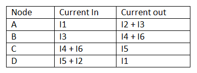

According to what you said, I managed to get the following (all though unsure if it is correct)
I am having trouble finding the voltage drops
If E = IR, and we are given only E and R, we can calculate I.
How do we get a voltage drop in this case? IR will always equal E if I solve it this way.

But that is exactly what the voltage drop is!
Look back on the diagram (top). Take the left-most loop and walk it from A, anticlockwise around to C and then back to A again... this gives:
[tex]-10I_2 + 400 -10I_1 = 0[/tex]
Can you see why?
The arrows on the resistors point against the current because that is the direction of increasing voltage. We just list the positive and negative voltages we encounter on our walk on one line then finish it with "= 0".
The way we are going, the first thing we hit is the left-most 10 Ohm resister, it's arrow opposes us so the effect is negative, the current through the resister is I2 so the volt drop is -10I2. The next thing is the battery/thing - we are walking in the direction of it's arrow so it's positive at +400V. Then there's another 10 Ohm resister, opposing us, with a current of I1 through it. That completes one loop, so I just put "= 0" on the end of the list.
Now you do it for the others.

Is my equations for the current going through the nodes correct?
also, I'm a bit confused on one of the loops.
Dunno, I haven't checked. Remember, I'm not supposed to do your homework for you. When you understand what you are doing you'll be able to tell anyway.
You think there is only one voltage drop in loop 3? How can we check this? Let's walk around the loop - start at node B and go anti-clockwise (it's my favorite direction as I'm very sinister).
From B-C we encounter a 10 Ohm resistor whose arrow points against us (you forgot to draw the arrows on the resistors - they always point against the current) so that you get a factor of -10I4 from this.
From C-B round the long way we come to another, unknown, resistor whose arrow is with us so this adds a factor of +RI6 after which we end up back where we started. So we put an "= 0" on the end to give:
-10I4 +RI6 = 0
How many voltages was that? I make it two!
With three loops and four nodes you should have seven equations. The six currents and R make seven unknowns - so you have a system of simultaneous equations. Have fun.
