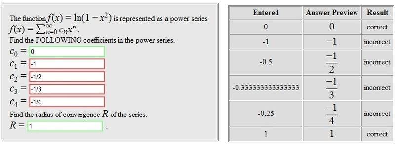

Okay so here's another similar problem:
I first differentiated the function [itex]f(x)=ln(1-x^2)[/itex] and wrote down the power series for it:
[itex]\sum\stackrel{∞}{n=0}(-2x)(x^2)^n[/itex]
Then I integrated the power series to get a series for the original function:
[itex]\sum\stackrel{∞}{n=0}(-2)\frac{x^{2n+2}}{2n+2}[/itex]
There was suppose to be a constant of integration but I found it to be zero, so after expanding the series for five terms, I found the coefficients to be:
[itex]0, -1, -1/2, -1/3, -1/4[/itex]
After inputting these numbers, as seen by the above picture, the web page said they were wrong; can someone tell me why?

I think the homework is expecting c1 to be the coefficient of x in the series. That's zero. The first nonzero term, -1, is the coefficient of x^2 in the series. That should be c2.
I tried what you said and it turns out c1 is indeed zero, meaning c0 is zero, c1 is zero, and c2 is -1. However c3 and c4 are still wrong; I used c3 = -1/2 and c4 = -1/3, and the web page said they were wrong?
You aren't thinking about the powers of x in your series. It's -x^2-x^4/2-x^6/3-... isn't it. c3 should be the coefficient of the power of x^3. Etc.
Oh well that works, c3 is actually zero, and c4 is -1/2, but what I don't get is why these numbers don't correspond to the exponent of x. For example, x^3 corresponds to the coefficient of -1/2, but instead x^3 corresponds to the coefficient of zero?

The attachment says the series is c_n*x^n. So c1 is the coefficient of x, c2 is the coefficient of x^2, etc etc. The odd powers are missing from your series, so all of the odd coefficients should be 0. Right?
Yes that's true, but the terms that are suppose to be missing are the even terms; expanding the series produces exponents of odd numbers, that's why I'm confused as to why the even numbers are showing and the odd numbers are missing.

2n+2 is even, isn't it? That's the exponent. What do you mean 'exponents of odd numbers'?
Whoa my bad, my scratch paper was conglomerated with numerous revisions of different series, making me look at the wrong one. :rolleyes:
